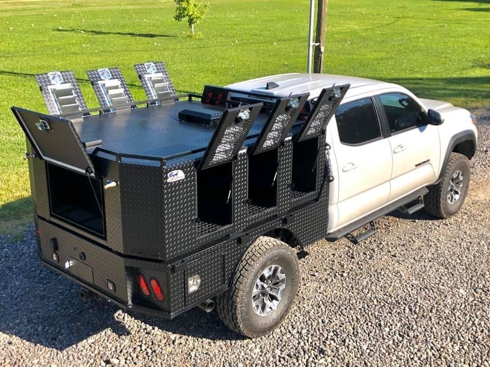

    The weight of at least the box is constant, airbags would work but I’d go with upgraded leaf pack for the constant weight rather than airbags. Airbags are great for compensating for a trailer once in a while, but I couldn’t see having to run them at 30-40 pounds all the time for a constant load.

    So that dog box is modular I see. It tensions down and can be removed whenever you want. Pretty slick.

    Watching the Aussies on 4WD/7 on YouTube and those guys run similar Trays on the rear of their trucks and none of the guys run shocks with reservoir. They are running long, tough tracks on tube shocks, like the 2inch Tough Dog. Along with air bags at low psi off-road. Definitely a different mindset than here in North America where we like shocks with external reservoirs.

    First I would figure out how much lift and tire you really want. What size tires do you want to clear? Honestly I’d start with a set of 5100’s and consider a custom leaf pack for the back. Atlas makes great stuff and will custom make a set for your needs.

    255 80 17 or 255 85 16 tires on OE wheels will fit no lift no rub no cutting. Also easy to find in E rating, good for your load.
    When they install the flat bed that's a good time to box the frame, treat it inside with Fluid Film, upgrade the leaf springs/shocks/bump stops.
    New set of gears for F/R axles.
    New front shocks/springs may be in order as well.
    Winds up being a fairly substantial investment to get it right.
