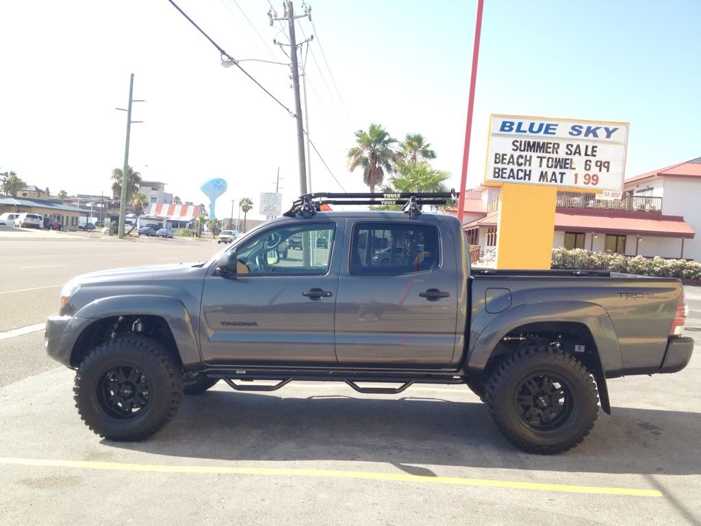

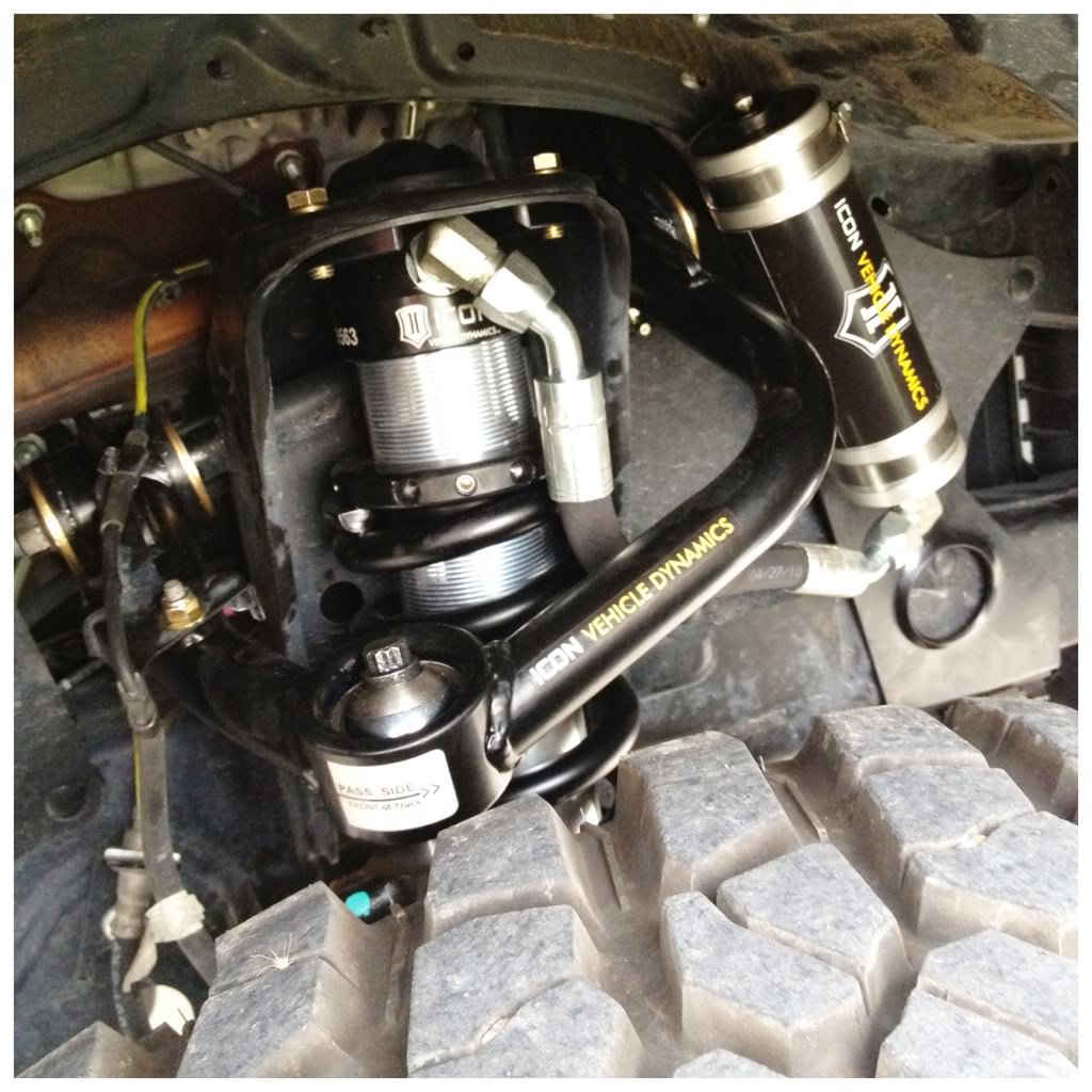

    I bought my icons about 3 months ago and unfortunately to get the ride height that i want, i had to crank up the coilovers, as u can see in d picture, resulting to somewhat of a stiffer ride. What are my options to be at my current ride height or higher (max 3 inch of lift) but putting my coilovers back to zero or just at 1 inch? I was doing research here and im really liking how d spindle lift looks but i unfortunately i have a 4x4 truck and it said spindles dont work with 4x4? Did i understand that right? Ultimately, i also want to add the Allpro 3in leaf pack for the rear, so any advice would be greatly appreciated! Thanks again

    Get a higher spring rate coil. You can lift with less preload.

    How do i go about doing that? U mean I change out my current coils to the higher spring rate coil. Can any shop swap d coils or i have to send it to icons. Thanks again

    Call Downsouth Motorsports (or a local shop if you have a GOOD local off road shop). You can either get a higher rated coil or a taller coil (or both). That way you can get the lift you want without the preload. If you want a softer ride, I'd go for a taller coil at the same spring rate.

    What rims are you using in that pic? Like them

    Thanks man, they are mickey thompson sidebiter 17x9

    All season mats, 2nd filter delete, DT header, Jardine cat-back, URD shifter, Bilstein 5100's all around at .85 front with Eibachs + .25 passenger/.5 drivers spacers and 1.5 AAL, 0w20 synthetic, Scanguage II, extra D rings, OEM backup camera+Mirror, bed mat, Extang Solid Fold, Popnlock 5300, Pro Comp 7089's 4.5bs 285/70/17 Revo 2s, De-badged
    nice, im guessing the tires are 285/70/17s too?

    You'll have the same issue with any coilovers cranked too high......its for performance and minimal lift unfortunately. I lowered my icons to 2.5" and have AP's in the back....there's some rake but it looks good! Try lowering them 1/2" and see how they ride!

    Thanks man and yah dats wat DSM said as well, either lower it or change it to a longer coil which is about $190 plus d install cost and might not even dat much of a difference to what i have now ride wise. U said u hav d allpro leafs in d back, do u have the 3inch? Thanks again

    I'll take pics in the am......how much thread do you have showing between the top and the collar? Are they ext travel?

    Oh dont worry about it man, no rush. I have the pic on top of dis page. Is dat how urs look like?
