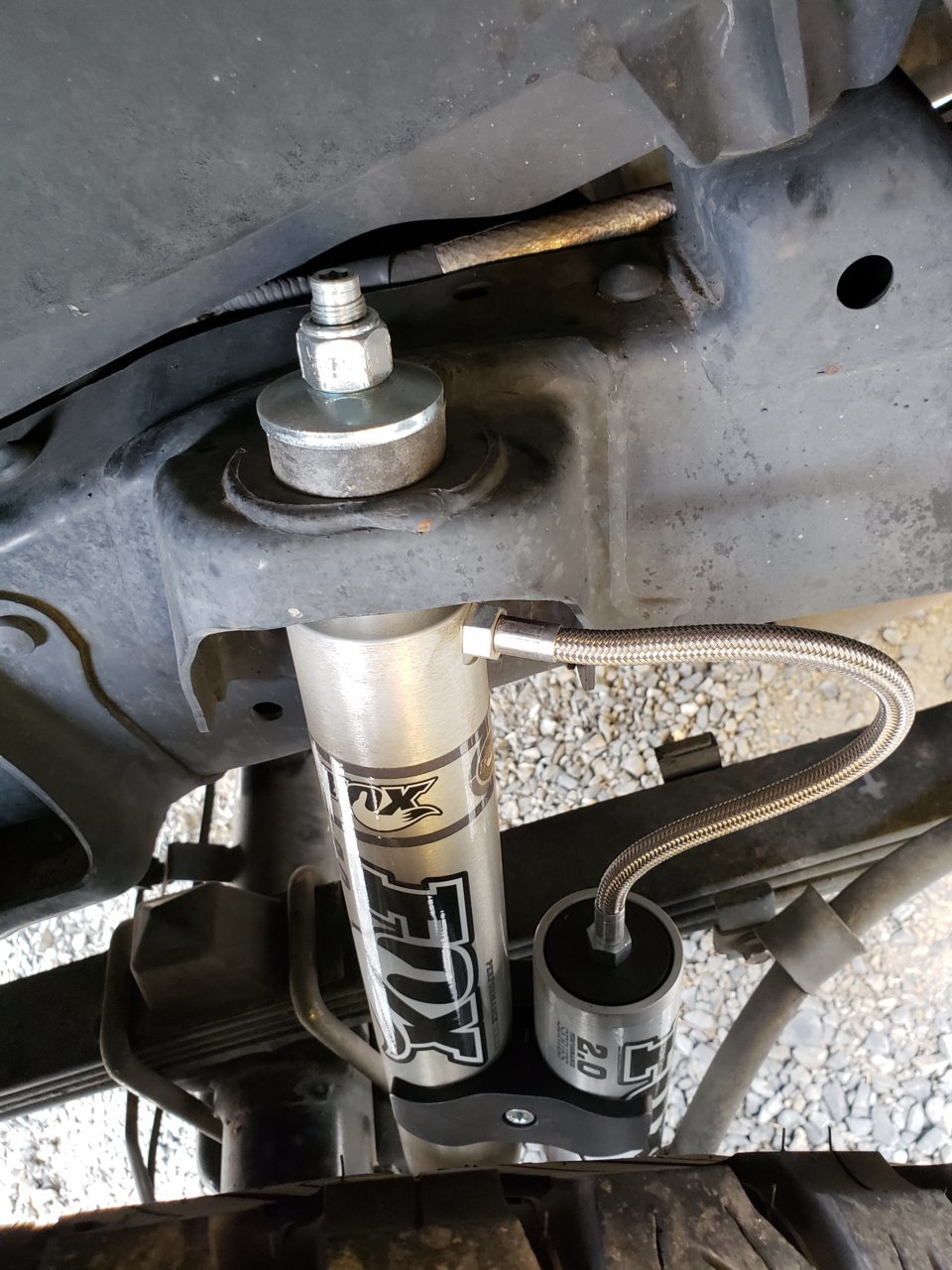

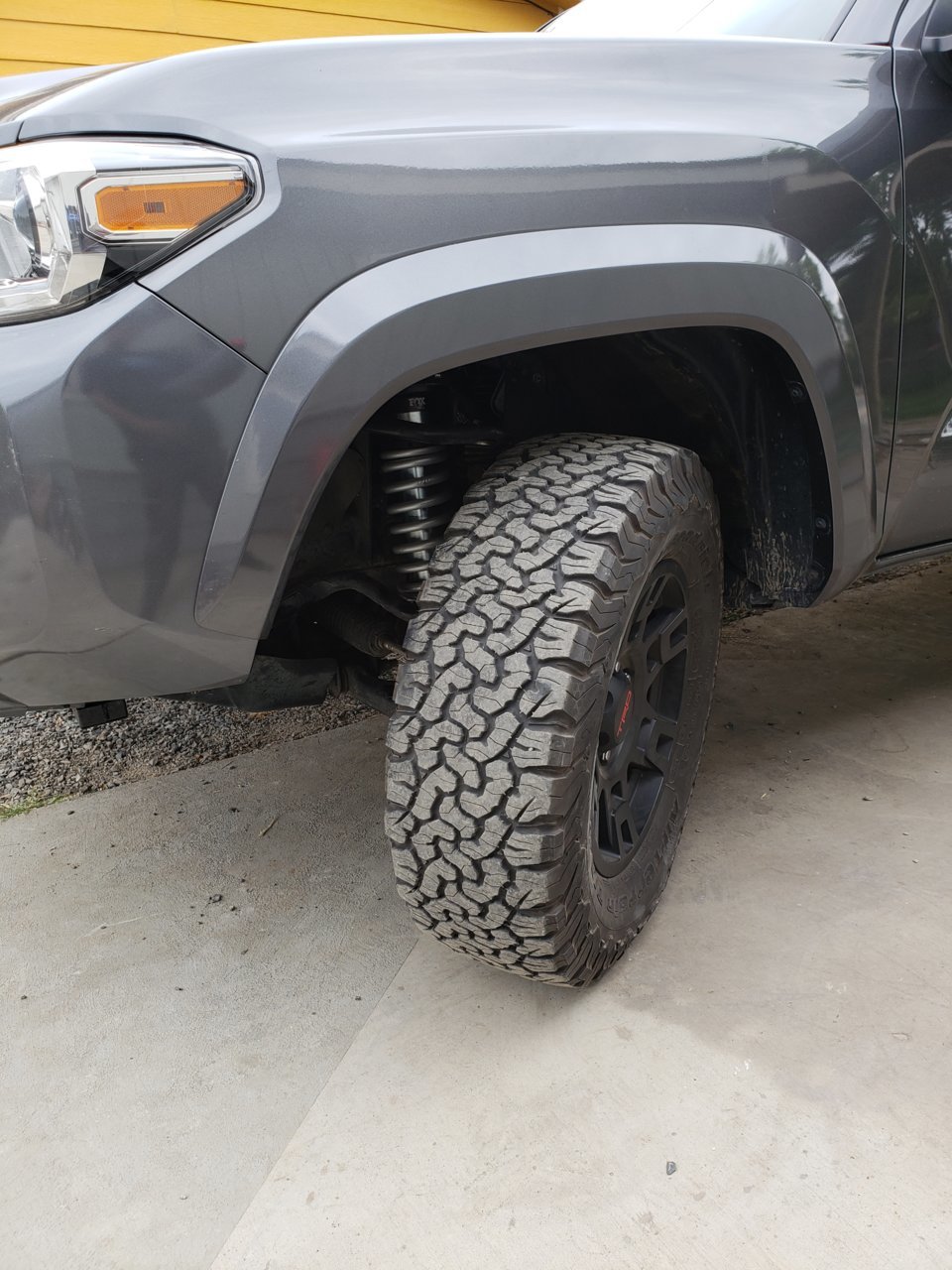

    @nosamk
    Also in the pnw
    Im currently running that same fox kit on my 3rd gen sport 4x4. It's a super soft ride. Almost too soft, but I haven't cranked up the front coilovers or added the rear AAL yet. So maybe the ride quality will change after I add preload to the front coilovers.
    Also I believe they come with coils that are 600# spring rate so if you're looking to add any weight in the future might want to look into something with a 650# or 700# spring rate, cause that's what im dealing with now

    Thanks man!! I dont have plans for a bumper [or shell] so I should be fine with the 600#. also planning on the dakar pack instead of an AAL. Did you alter the preset/factory ride height they come set at? what kind of increase did you get?

    #242088
    3
    16 trd sport dcsb 4x4
    They come set at 2" for second gen, or 1" for 3rd gens. So it pretty much just leveled it out. I'm hoping to get atleasst 2" in front and 1.5" aal in rear. Just waiting till I have the time to install it all
