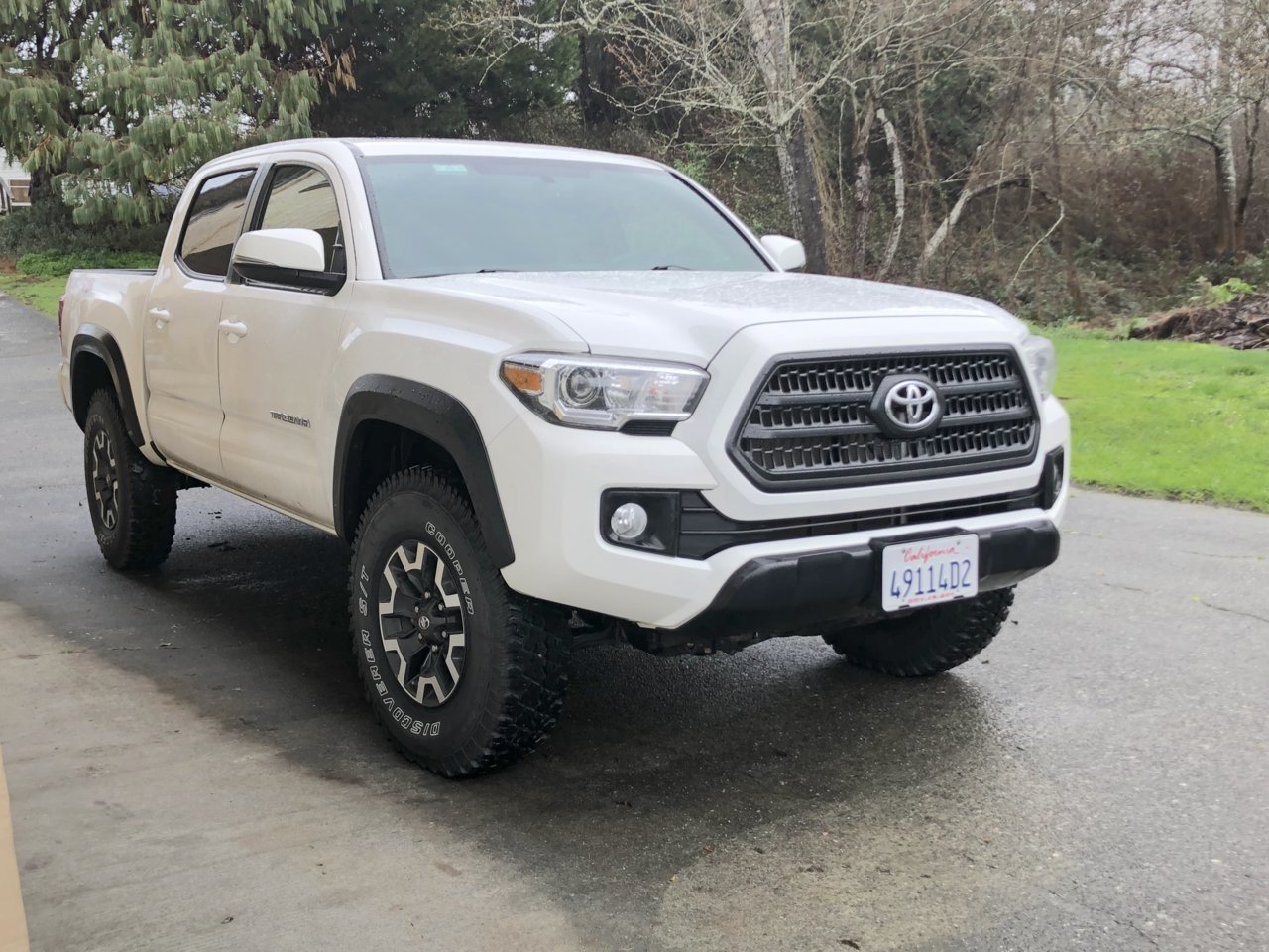

    I know this a noob question, but I come from a drifting/autoX background so I only understand car suspension well, lol.
    What are the real benefits of going with an expensive setup (king, radflo, Fox, dakar leafs, camburg UCA’s, etc.)
    over a simple setup? (Bilstein 5100’s, OME springs, SPC LR UCA’s, icon AAL... the previous setup on my last truck)
    My truck will be on the road 70-80% of the time, but when I go off road I tend to push things pretty hard if I have a recovery rig with me, lol. I jumped it on the beach once while it was stock, probably not gonna do that again. It will be seeing a lot of snow, a little beach, and some woods.
    I’d want about 2.5” of lift and would run 265/75’s or 285/75’s if I’m content with horrible mpg’s. Currently on 255/85 coopers and they’re almost as heavy as the 285’s on my last truck.
    Here is my blank canvas... I owe about $6k on it, but after it’s paid off I may start being stupid again and I’ll need you guys to spend my money for me :rofl:
