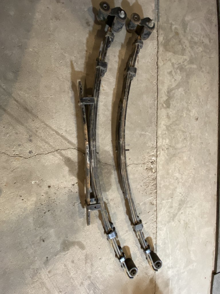

    Anything needed to keep the add a leaf from turning sideways? Does this look correct?

    Looks good to me. Ubolts should be sufficient in keeping the AAL from shifting. As stated earlier by @Musubi3 , if you need more height you can put the overload back in. Just remember it'll also ride stiffer.

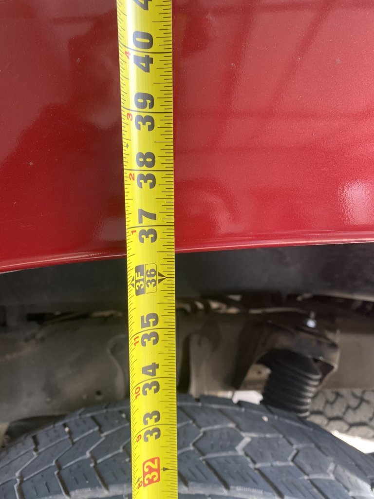

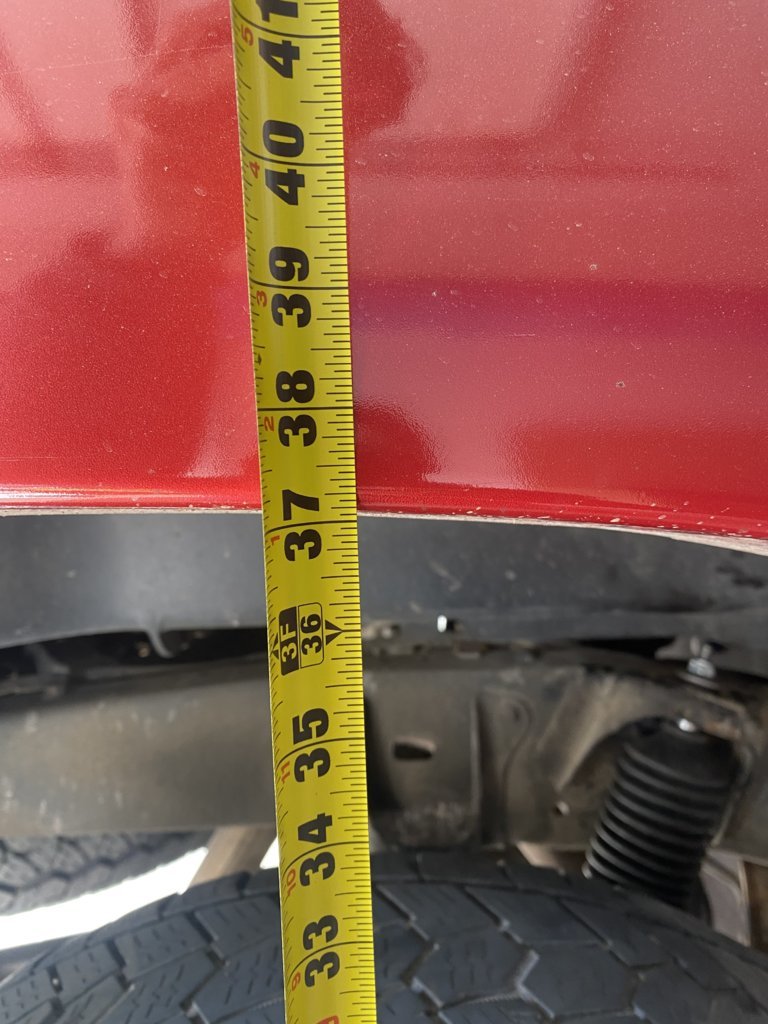

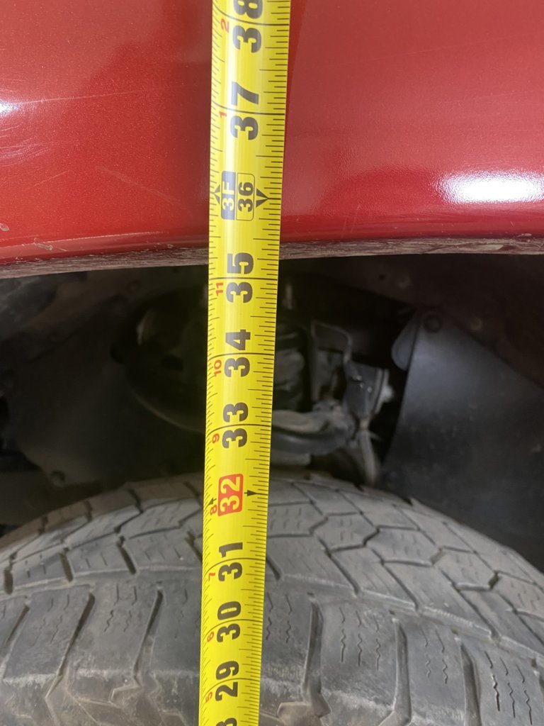

    Thank you everyone for the advice. Everything is installed, passenger side definitely higher front and rear. Will it settle some?

    1/2" difference is normal. It's called the "Taco lean". Its from the battery and gas tank both being on the driver side. Some people toss a 1/4" top hat spacer on the driver side to compensate for it but it's not really a problem.
