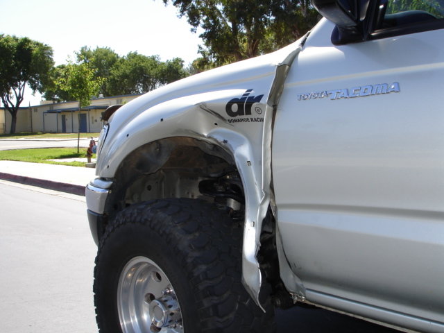

    OP, you definitely wanna look into that LBJ bolt. Not a very fun outcome if you lose all four. This was my damage...
    Luckily I wasn't on the freeway goin 40+mph. On the plus side though. Was a perfect reason to get front glass put on ;)
    Good luck with your problem
