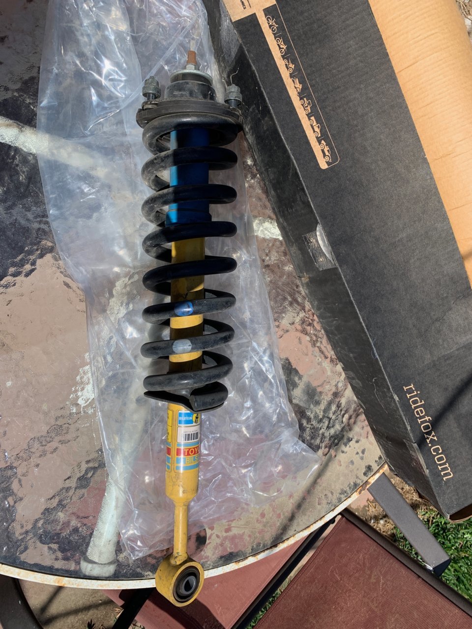

    upload_2019-5-16_14-52-32.jpgThis is my stock coil over here
