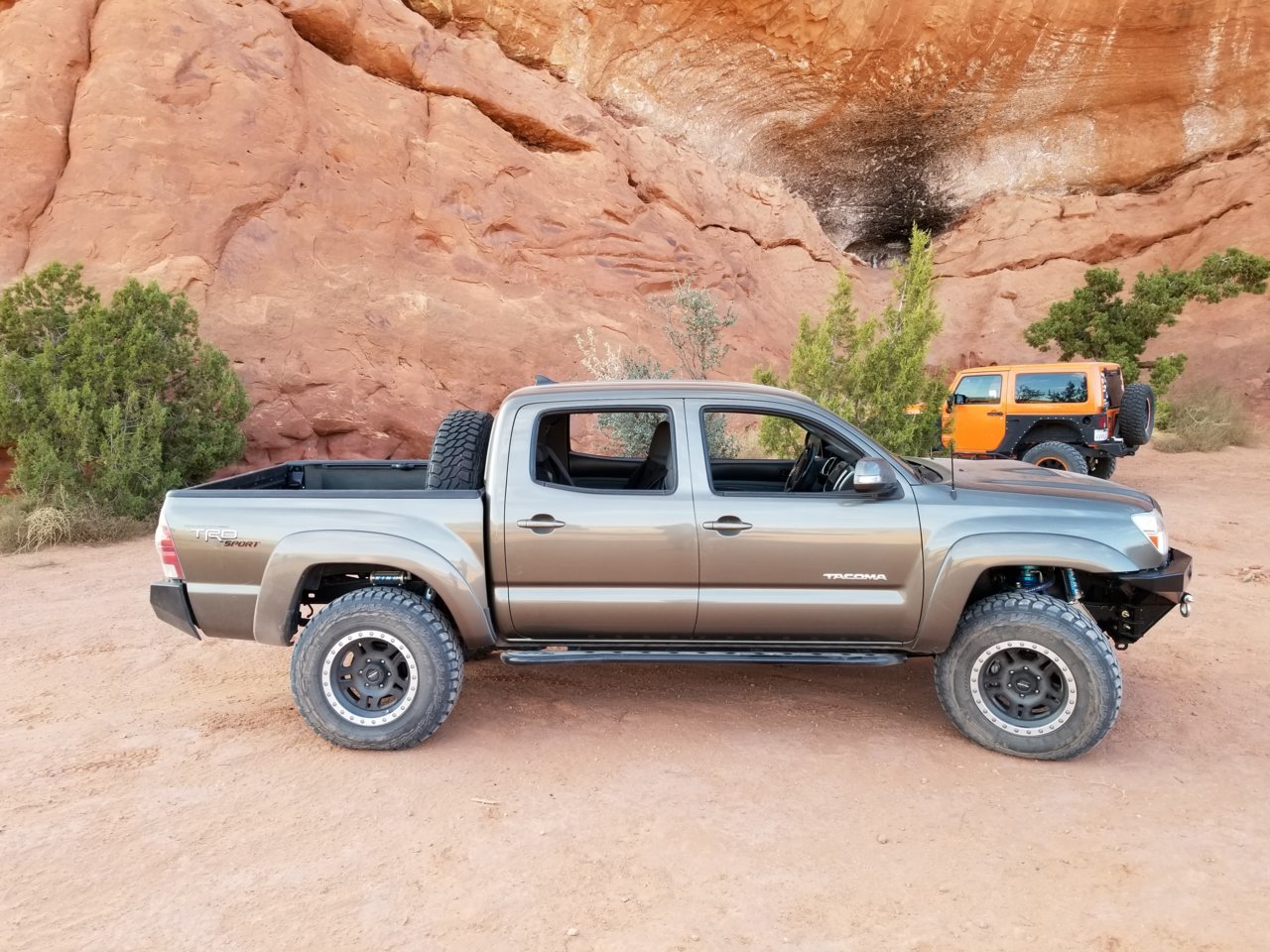

    I went with extended travel Kings and expedition springs. My truck has a slight forward rake.
