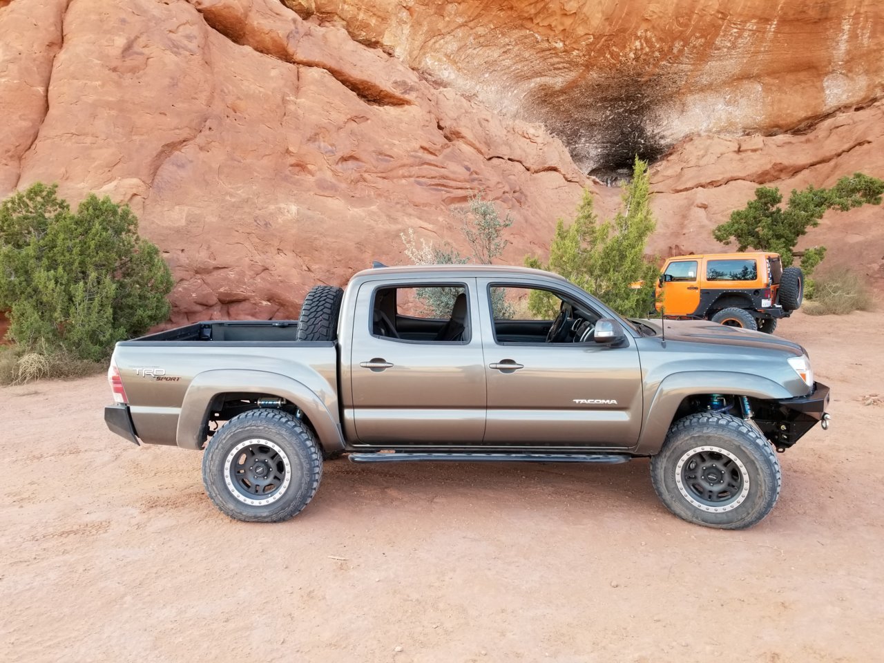

    700 lb springs. Extended travel 2.5" lift with full steel plates and a 10K winch. 3" expedition springs in the rear. See pics.
