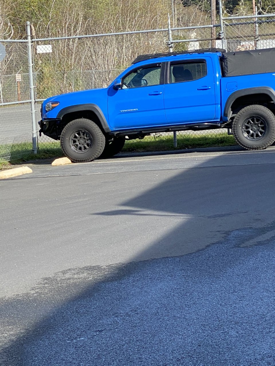

    So I’ve searched through the archives of the forum to try and find what I’m looking for and haven’t been successful. I hope nobody gets mad about a new thread. So I’m trying to raise the front end of the truck since adding a bumper and winch made it drop a bit. I’m running OME BP51 setup. I measured from top of tire to fender. The front is about 6 1/2” and the rear is 8”. What’s the best way to level it out a bit. Spacers? I don’t want to preload too much on the front coil overs. 60B0EE6B-A0AB-4551-A5DF-6C9240EB494F.jpg

    Preload. Can you exchange coils on the BP-51?
  3. Feb 25, 2020 at 5:42 PM
    socalexpeditions
    socalexpeditions IG: @socalexpeditions
    Sep 22, 2017
    #230791
    5,388
    FWIW I think it looks perfect. Just enough rake that when you have gear in the back, it levels itself out.
    But to answer your question --> you can either preload the spacers a little bit, or switch to a heavier spring rate and taller spring.
    For instance, you can go to a 14" 700lb spring and you'll have little-to-no preload.
    Try preloading the coils more and see if the ride quality changes. If so, just get a 14" 700lb spring and be done!

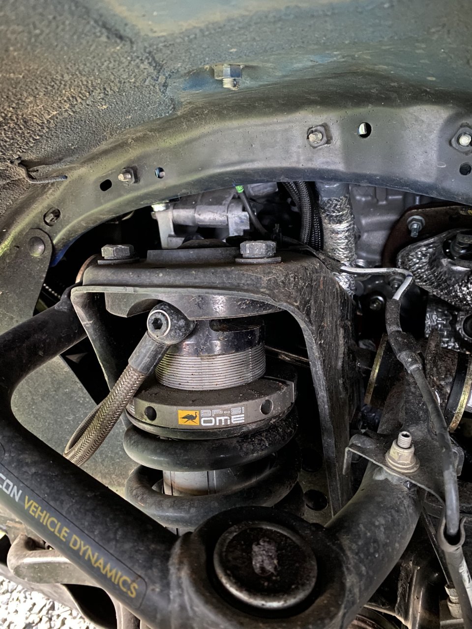

  10. Feb 25, 2020 at 5:59 PM
    socalexpeditions
    Sep 22, 2017
    #230791
    5,388
    Oh you got room, crank it down 3 turns each side and see where it falls.
  11. Feb 25, 2020 at 6:04 PM
    2manytacos
    2manytacos [OP] Member
    Feb 24, 2020
    #320281
    17
    2020 voodoo blue Tacoma trd
    that’ll have to be a weekend project for sure. I’m guessing they’re not the easiest to crank down on. I’m just worried about ruining ride quality.
