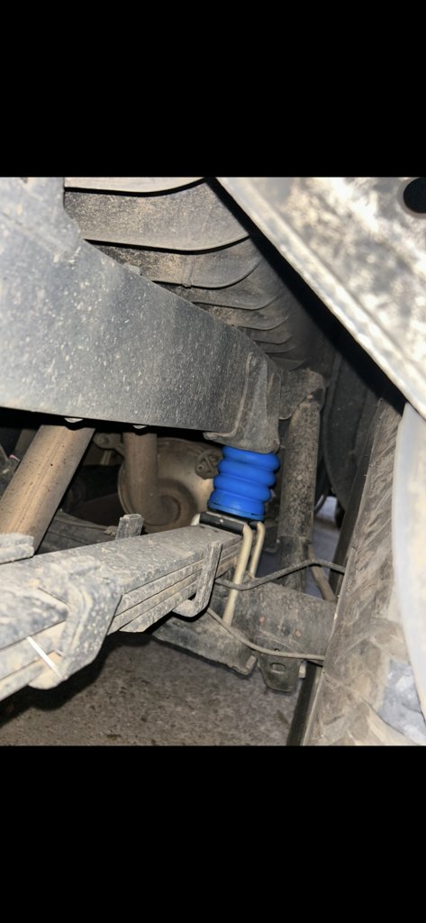

    I had a leer wedge construction cap installed last year /2024 it’s a 23x30 wedge construction cap. I use this truck primarily for fishing and camping. I have a small platform with a drawer inside estimate about 200lbs of stuff inside topper. I pull a 16’ war eagle boat with 40 hp outboard. When I hit a medium to hard bump, it feels like the shocks bottom out. I installed a set of sumo bump stops and that helped the bottoming out but it rides like Chit. The truck is a limited and has small shocks, not the same as the TRD trucks. My question is. Should I upgrade to the Bilstein shocks or other upper shelf shock in addition to the bump stops. I’m trying to be a good steward and not add stuff I don’t need. And suggestion or advice is welcomed. I’ve been through the add a leaf, spacer thing with a Jeep. I’m trying to get advice so I don’t chase that rabbit again. Thanks in advance!

    You need new leaf springs. Icon rxt in stage 2 would be my suggestion. I went that route, I was in same situation. You could do 3 leaf and a leaf. They work for awhile, but flatten out in time.

    I replaced my truck's 7 year old stock leaf springs as soon as I could after buying it. I have zero faith in Toyota leafs beyond one bicycle in the bed.

    Ok, I was thinking that when I was under the truck installing the sumo bump stops. Seemed like the bump stops were a bandaid to a bigger problem. Thanks

    with that kind of weight, I think you are correct. One thing to note; most aftermarket rear leaf packs are also designed to add additional lift. You might consider that when looking.

    Here’s the bump stop fellers and fellets.

    As others have mentioned, Icon springs are great. I got them because I liked the adjustability. I have mine set on option two and I don't even haul or tow that much. But when I do, they hardly sag at all. Definitely worth looking into. Deavers and Dobinsons are also really good as well and worth looking into depending on your price point.
