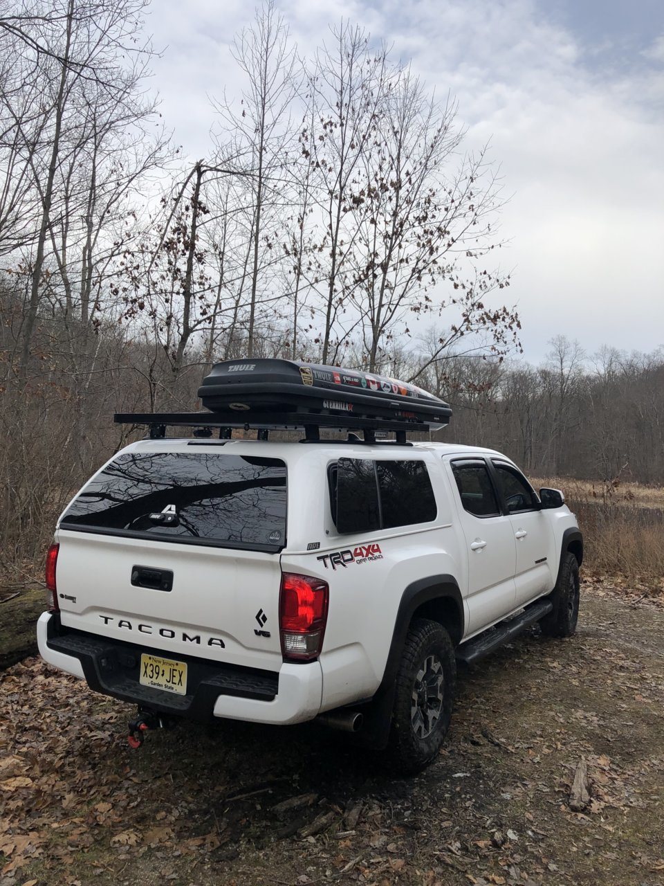

    I recently added an ARE Z series cap with a Slimline 2 rack to my Off-road short bed. Ever since doing so I fell like the truck rides like a boat because the rear shocks are preloaded. Also, if I hit the wrong dip in the road I could feel them bottom out.
    Prior to this I ran just a Slimline bed rack and my Frontrunner RTT, with that weigh the driving dynamics felt fine. I havent even tried the tent on top of the cap yet.
    What would you advise I do to the rear suspension? Add a leaf? Is that all I need? Also, if I do the back should I also compensate the front to match?
    Thanks in advance.

    I ended up installing the ICON AAL 1.5 inch today. One of the bigger jobs I’ve done on my own. The biggest pain was grinding off the leaf clips from the oem leafs to make room for the AAL. Had to do one one each side.
    The ride def feels stiffer and more like it was priory to installing the cap.
    Also, my ground to fender distance went from 36 in to 37.75, so a little more than I bargained for. I’m sure it will sit a quarter inch after it all settles.
