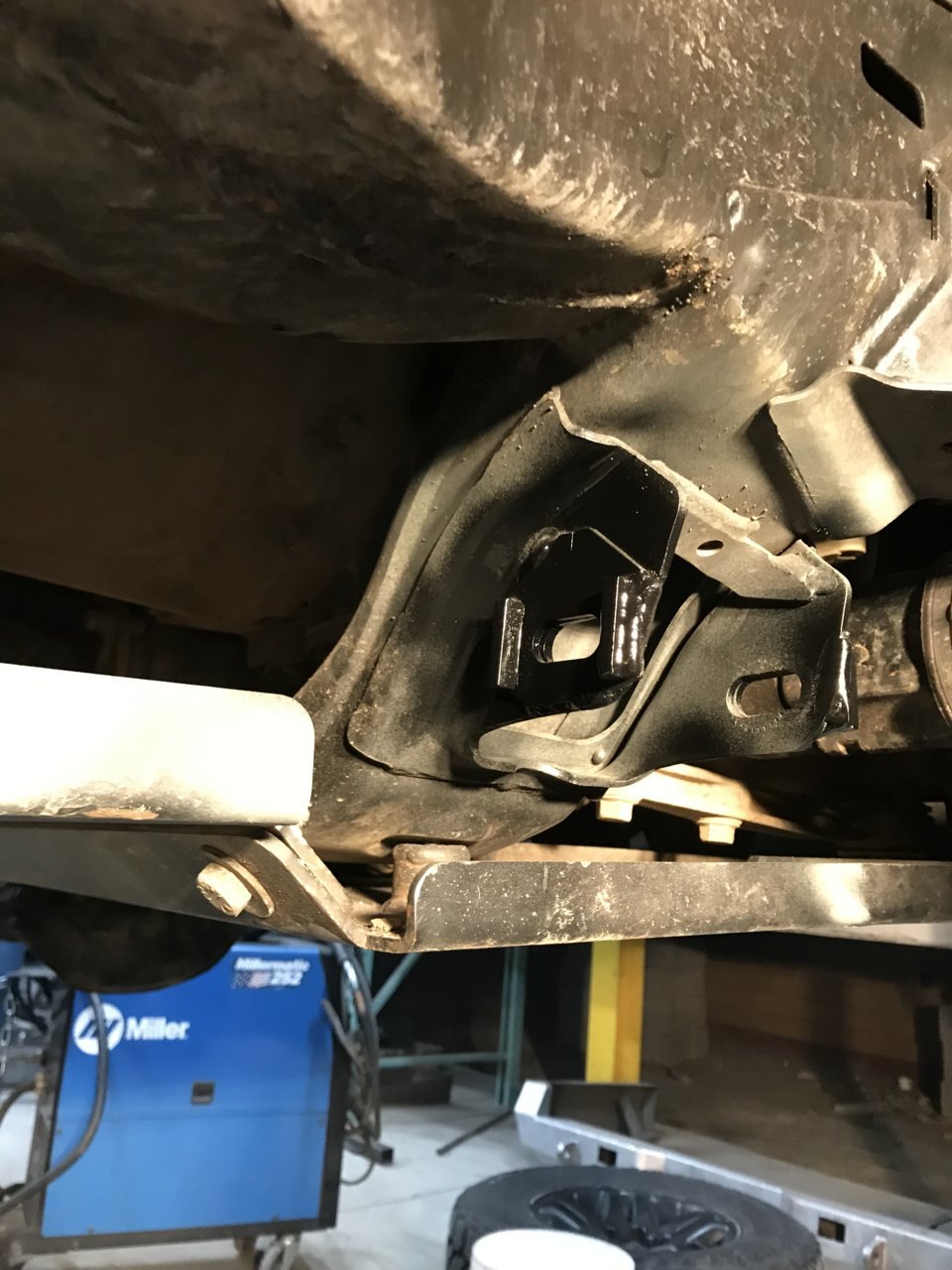

    There's a good chance you'll only need to adjust those to tweak the alignment. The shop can do the full suspension install without touching them and still get it aligned pretty well. Gives you time to get the parts/money together if you don't want to spend the extra right now.

    No, that’s a different thing. The tabs are what hugs the alignment cam, and causes it to rotate. With those flat, there’s nothing for it to rotate against. A common fix is to replace them with beefier counterparts.

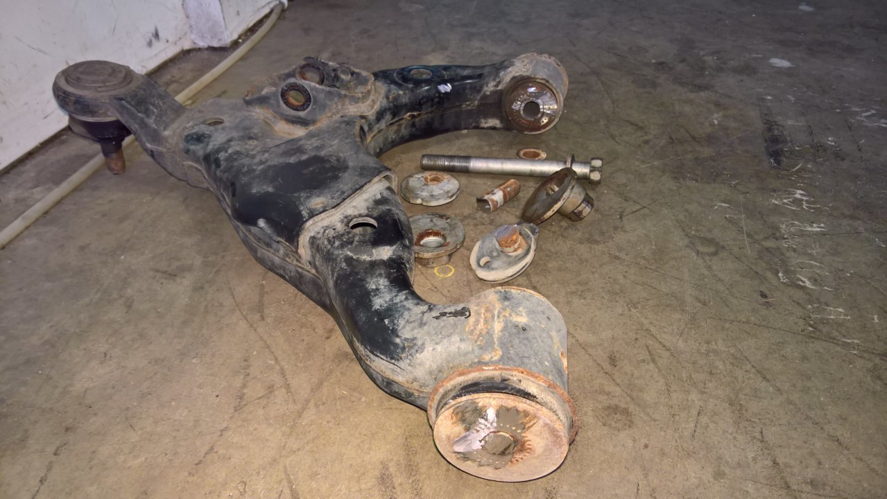

    2014 T4R. Cut out the LCA cam bolts. Two ways to repair. Press the bushings out and replace with new and new cam bolts, or buy replacement Moog control arms that already have bushings and new ball joint in them. Personal opinion, would be cheaper to replace entire control arm than to pay for labor on new bushings.
