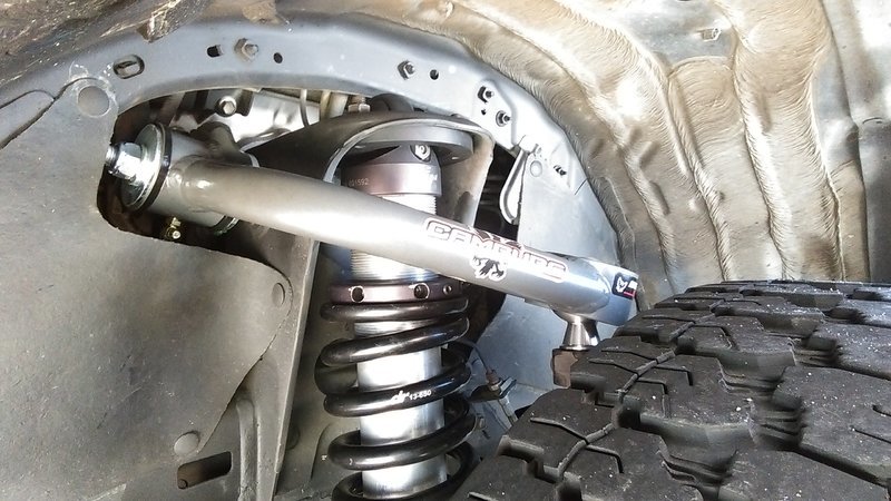

    I just did my front end this weekend. It was hot!!! Rebuilt my old DR coil overs (new seals, new fluid, fresh nitrogen charge). Finally broke down and bought and installed new Camburg UCA. While I was at it installed new EBC slotted/dimpled rotors with green pads. Took about 12hrs because I had no idea what I was doing rebuilding the coilovers. I definitely suggest finding the ez-up and having a lot of cold water/beer at hand. Now it just needs alignment. Back to driving like a champ.IMAG1504.jpg
