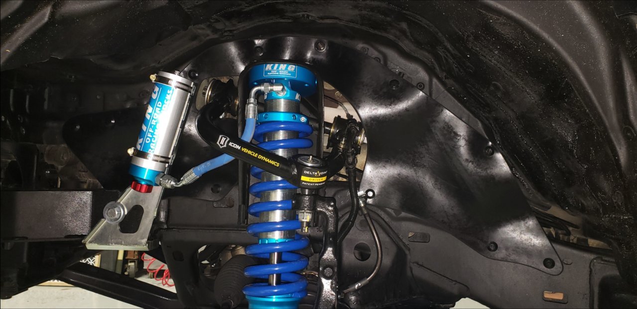

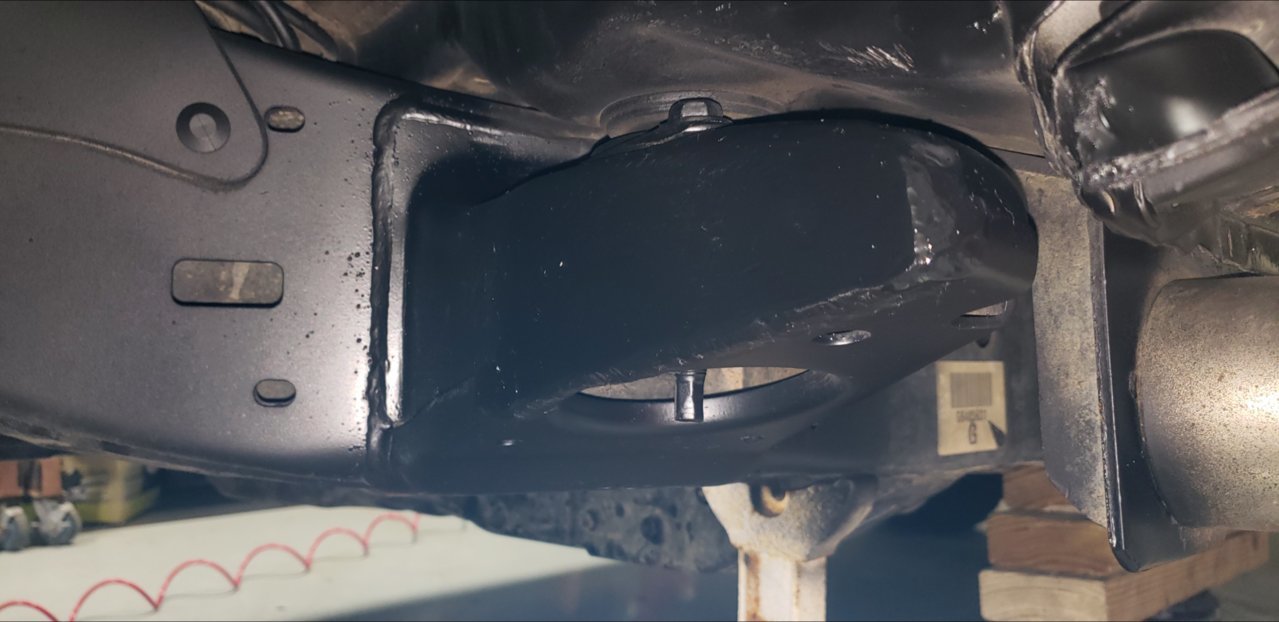

    My front suspension took me several days. I pushed in all new bushings, ball joints in the LCA. Doing it again I would probably just replace the entire lower control arm. It took extra time too because I wanted to clean, paint, etc. I would say it can be done in a weekend... If you have everything you need or want. Mine kind of evolved on the fly. Screenshot_20200223-101422_Gallery.jpg Screenshot_20200223-101015_Gallery.jpg
