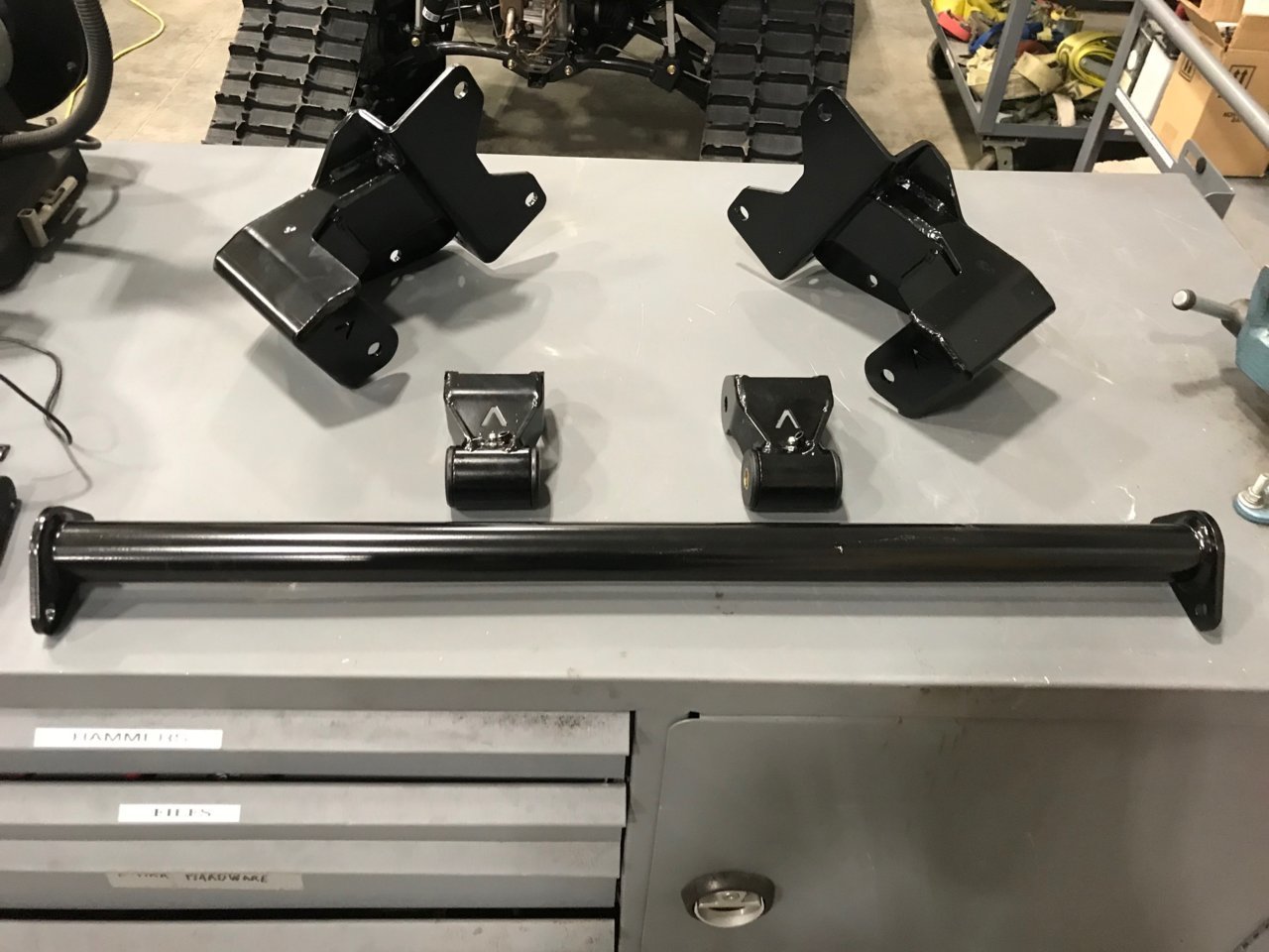

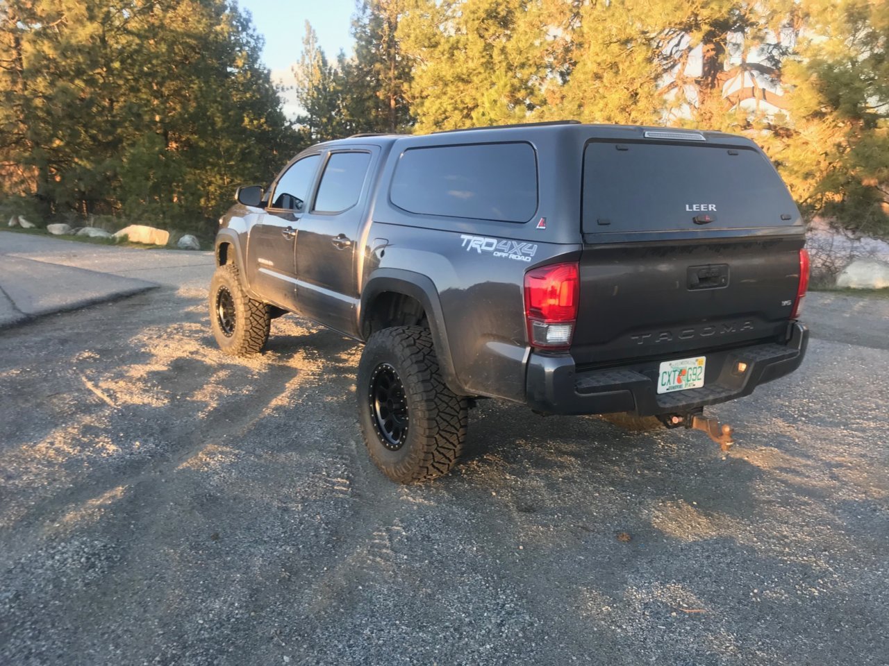

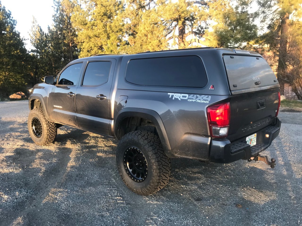

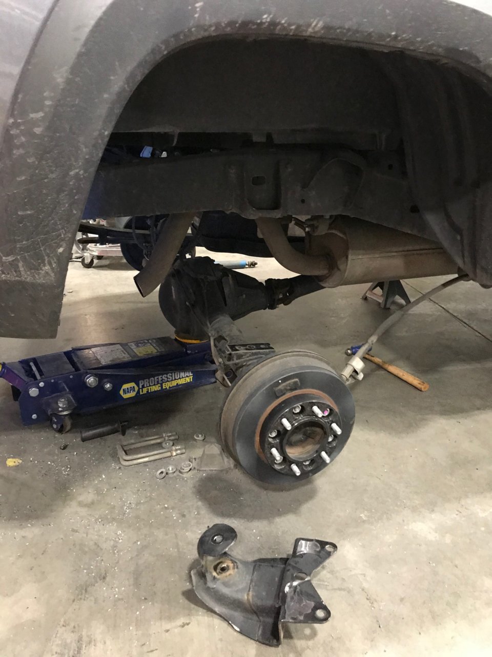

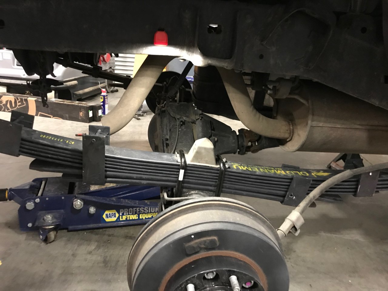

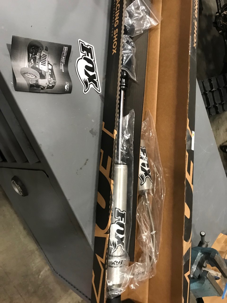

    I'm a little late posting this, but I finally got everything installed (suspension).
    What I installed:
    Front:
    -IVD, Tubular, Delta Joint UCA's
    -Fox 3.0" extended travel, adjustable coil-overs
    Rear:
    -Archive Garage Hammer hangars + cross member/tube
    -Old Man Emu, Dakar, heavy pack leaf springs
    -Fox 2.5", remote reservoir shocks
    Wheels & Tires:
    -Method NV 305 17x8.5
    -Nitto Ridge Grappler 295/70r17
    The front was pretty simple and straight forward, I just had to get creative when it came to removing the long bolt that secures the factory UCA's. Other than that it was very simple.

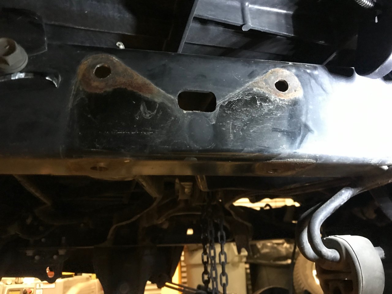

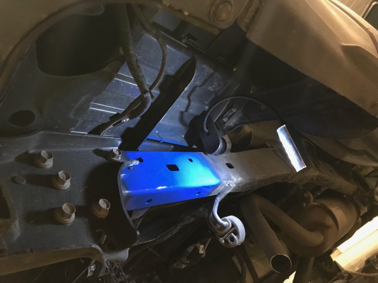

    The rear was much more involved. The right tools, and knowledge ahead of time can save a ton of time and effort. Grinding down and drilling out the facotry rivets to remove the factory shackle hangars was a pain, and by far the most time consuming portion of the install. Once the factory shackle hangars are removed everything else is a breeze.
    I forgot to take pics of the front install, but here are some pics of the rear: IMG_2046.jpg IMG_2050.jpg IMG_2044.jpg IMG_2030.jpg IMG_2031.jpg IMG_2032.jpg IMG_2037.jpg IMG_2040.jpg IMG_2041.jpg IMG_2042.jpg IMG_2044.jpg IMG_2051.jpg

    Quick tip to try for next time. When I removed a lot of factory rivets holding on suspension mounts on my old Chevy project I found a nice sharp chisel and a big hammer was the best way to remove rivet heads quickly and cleanly. Sounds like it'd be a pain, but it worked for me. Minimal grinding and definitely no drilling.

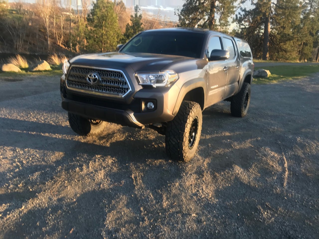

    I got about 2-1/2” in the rear, and adjusted the front to get 3”.
    I had to lower the front a little because I overextended my adjustable coil overs and I didn’t have any down travel In the front. It doesn’t sit quite as level now, but still looks amazing and rides so much better.

    Thanks for the tip. If there is a next time I will certainly keep that in mind as that process was by far the most difficult and tile consuming part.

    I lowered it below 3". From the factory it was barely more than stock height, which caused way too much rake once I installed my rear suspension. So, I adjusted it to ride level, but that is when I over extended it (possibly a little more than 3") so I lowered it below 3" which solved my lack of don travel and rough rude in the front. Although, the 10-ply Nitto's don't help much with a rougher ride.

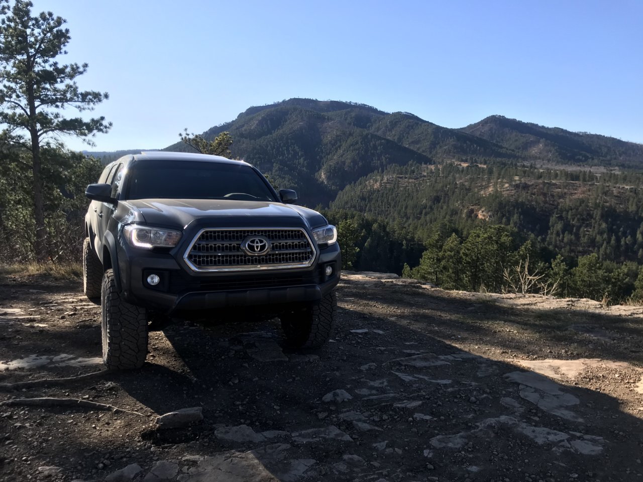

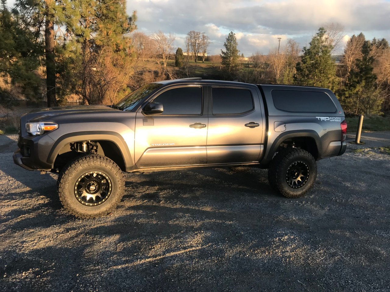

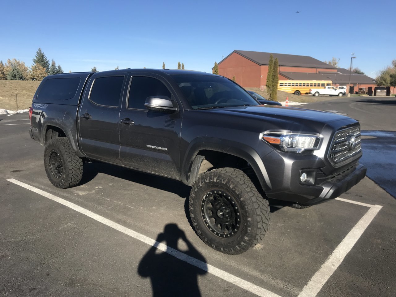

    #312232
    12
    2017 Toyota Tacoma TRD OFF-ROAD, DBLCB, SB, AT, MGM
    Many to come.
    Here are some more recent pics since I lowered the front. I don't have a good pic of my CV's, but my hub to fender spacing is less than 24", so I'm good. 62569902797__9AC86074-6823-4AEC-ACB5-461DE0FABA2A.jpg 62569902797__9AC86074-6823-4AEC-ACB5-461DE0FABA2A.jpg IMG_2593.jpg

  18. Dec 17, 2020 at 12:15 AM
    #18
    gotblika
    gotblika Well-Known Member
    Apr 28, 2011
    #55716
    895
    Maui
    2015 DCLB Sport 4X4
    5100'S 887 SPC B110 EL096R
    3rd gen’s should actually be limited to 2” lift (23”).
    Spokoma[OP] likes this.
