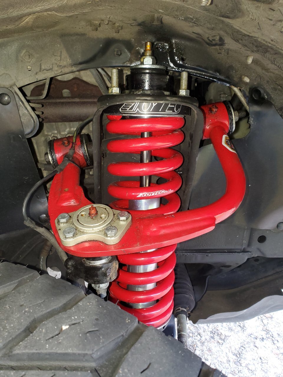

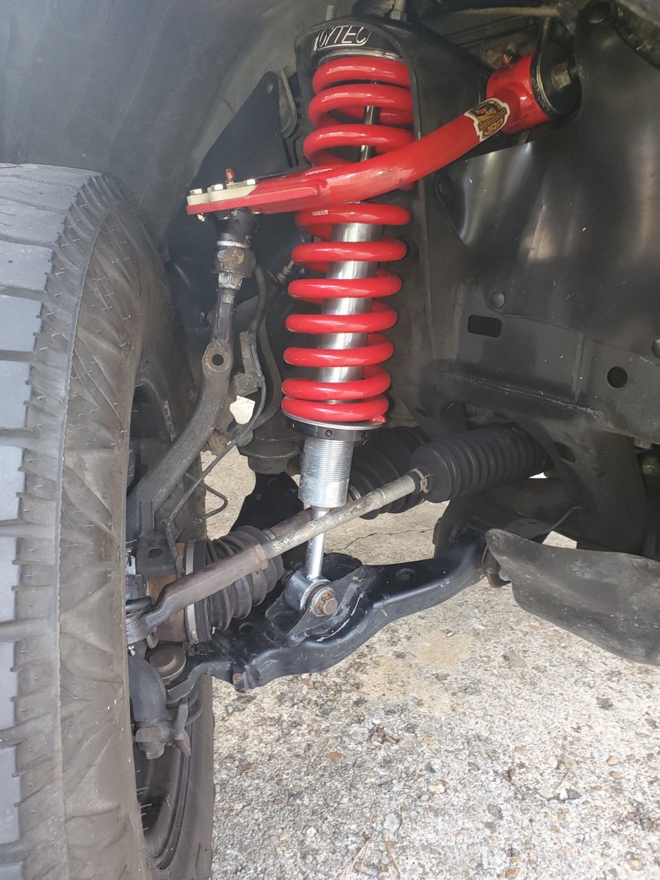

  15. Oct 19, 2019 at 11:21 AM
    SummitBound
    SummitBound Well-Known Member
    Nov 10, 2017
    #235633
    1,409
    Greenville, SC
    2019 T4R OR
    Can you post pictures of the setup on that side? We probably won’t see anything you don’t but extra eyes always help

  17. Oct 19, 2019 at 12:16 PM
    #17
    stickyTaco
    stickyTaco Fuck Cancer
    Dec 11, 2012
    #92904
    5,930
    Zack
    Reno/Tahoe
    '12 DCSB TRD-OR
    Fox/Dakar with Relentless goodies and stuff
    Post some pics of the suspension on the side that's giving you problems
    757yotas[OP] likes this.
  18. Oct 19, 2019 at 12:46 PM
    #18
    757yotas
    757yotas [OP] Well-Known Member
    Feb 5, 2015
    #147976
    2,105
    Virginia
    2007 TRD Sport
    ICI Magnum front bumer Rigid LED lighting OME lift 285/70 Nitto Exos 17" Fuel Hostage TRD Exhaust TonnauPro Cover Oil Catch Can Tint Pioneer Nav system Sound System LED lighting Euro headlights Paint
    Here are 2 pics, if anyone wants i can do a close up shot of whatever.

  20. Oct 19, 2019 at 2:24 PM
    #20
    DelinquentTaco
    DelinquentTaco Active Member
    Apr 26, 2012
    #77682
    35
    Colin
    '11 4x4 TRDOFFROAD
    TRD cat-back,TRD CAI,TRD quick shifter,N-fab lightbar & 2 Hella 700ff,AirHorn&compressor&2gal tank, LowRange Offroad leveling kit 3"and1", XDSeries Badlands Chrome 18x9, 285/65/r18 Nitto TrailGrapplers
    The only thing I can think of that would cause binding and or thud sounds would maybe be the bolt that attaches the coilover to the LCA. Maybe if its over torqued its not letting the coilover rotate properly when the suspension flexes? I'm grasping at straws here but maybe without the sway bar you're over extending something.
