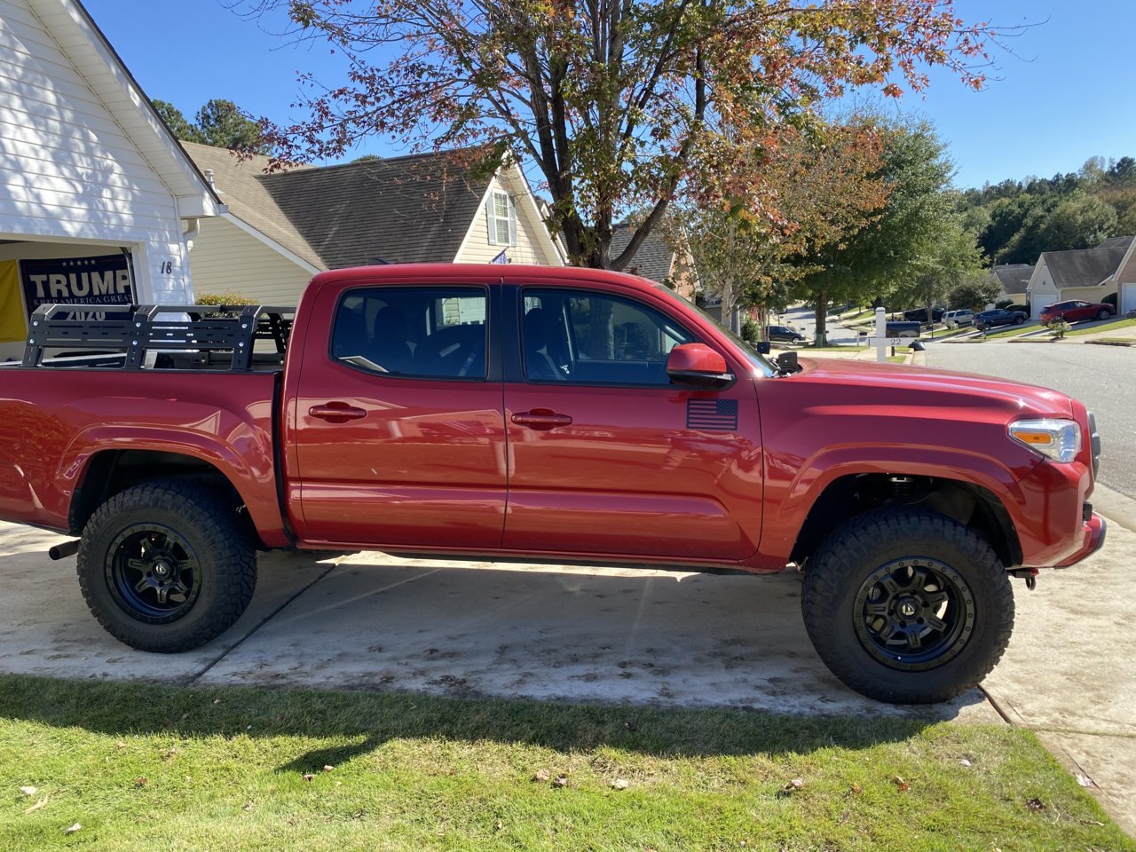

    I have a 2016 SR. I have a RC leveling kit now. But I want to upgrade suspension. It’s my daily driver. I rarely go off road more than just light trails but am slowly adding a little weight. Looking for advice for a nice ride and that lasts. FBEFD265-C2E8-42E7-9411-53CE588E7E86.jpg
