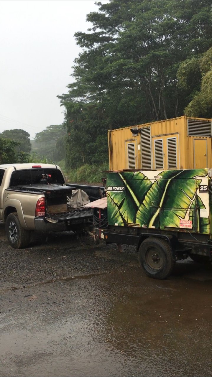

    Hey thanks for the replies bubble wrap, toku58, and bs63366. I’ve been looking at the dakars EL095R rear spring pack vs the crippled angler’s HD 4+1 spring pack. Anyone want to chime in on their opinions for these? I’m wondering how bad will the ride be when I go ride sands/off-road if I don’t have a load on the truck for either of these spring packs. I’m also looking at picking up a weight distribution hitch receiver. This is what I current tow on the daily. She sits pretty low and bottoms out on pots holes and speed bumps I can’t shift the trailer weight around. I just don’t fill the gas all the way up in the generator (oh and that machine on the tongue of my trailer is only there temporarily while I was parked)

    If you are regularly towing I would go with the EL096R leaf pack. The nice thing about doing the heavy duty pack is that if it winds up being to heavy you remove the overload and then you have the light/med duty pack. I have the HD pack on mine and it does just fine off road and I only have camper shell on the rear of my truck so far. Either way I think that helper bags and a weight distribution hitch will help you out a lot as well.
