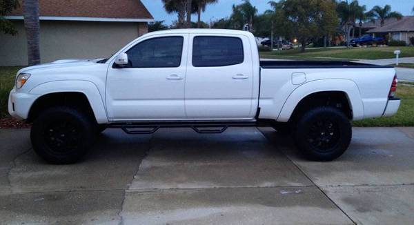

    All work done by 4 Wheel Parts in Orlando,FL. Ask for Pete or Paul

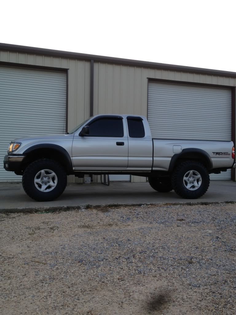

    3 1/4 in. front lift - 2in rear with 33x11.50x16
