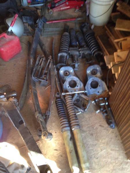

    Hello all,
    I recently purchased a used 6" kit for a steal. Only problem is that I don't know what brand and what a couple of the pieces are. This appears to be an "above coil" spacer kit using stick shocks and some extremely long test shocks that dont have any mfg markings. I'd like to replace the front and rear shocks with bilsteins but obviously don't know how to find out what part number to order. Also does anyone have an idea how to determine the brand of this kit?

    Geez!! I'm having some serious spelling issues.... I meant to say "STOCK" front shocks and "extremely long REAR shocks...

    pictures would/might help. We might be able to detective this shit for you.

    I posted a pic of the lift kit. It's in my gallery. (Sparkies coma) the pic is entitled "nameless lift" lol

    Toytec... they do good prices and fast shipping

    Is it just me or does this look like stock suspension with an above coil spacer?
