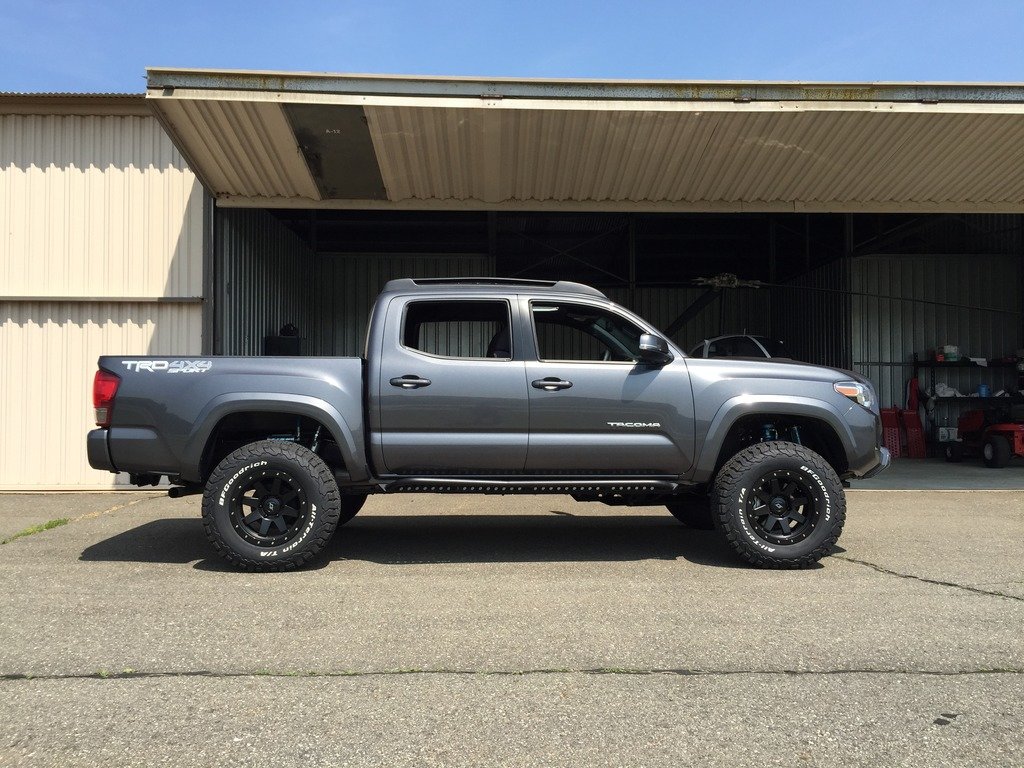

    17" SCS SR8's King 2.5" Coilover shocks with Remote Reservoir and 650lb coils King 2.5" Rear Replacement Shocks with Remote Reservoir ICON 1.5" Add-A-Leaf pack Total Chaos Suspension Upper Control Arms BF Goodrich T/A KO2 285/70R17 BAMF Grille BAMF CMC Plates RCI Sliders & Front, Xmsn, Xfer Skids SSO Slimline Front Bumper Baja Squadron-R Sport Fogs Baja Designs 20" S8 Lightbar Smittybilt X20 10K with Solenoid Relocated Factor 55 Fairlead & Flatlink JCR Front License Plate QR Bracket RCI Rear Bumper Rigid Instustries SR-Q backup lights Nitro 4.88 Gears ECGS 8" Clamshell Bushing InSight Retrofits BHLM Mesojdm Ultimate LED Turn Signals Breather Mod behind tail light Yeti Bed Mounted Bottle Opener Forty2's 3 Switch Panel with CH4x4 Custom Switches Relentless Fab Bedrail Hi-Lift & Dual Quickfist Mounts 48" Patriot Edition Hi-Lift Nox Lux blackout kit & 4Runner TRD emblem Bussmann Relay Panel Hondo Garage Premium Radio Knobs, Un-Holey Dash Mount, Perfect Squeeze Phone Mount Redline Tuning Quicklift Plus DZ Innovations Shiftsense Pro (not yet installed) coming soon: BajaKits LT Kit Synergy Rear Wheel 1.5" Spacers Ultimate LED mirror turn signals
    I'd take them over stock any day of the week, ride is 10 times better. They are firmer but in no way bone jarring, great improvement and couldn't be happier with my decision. I doubt you would go wrong with either Kings or Icon
