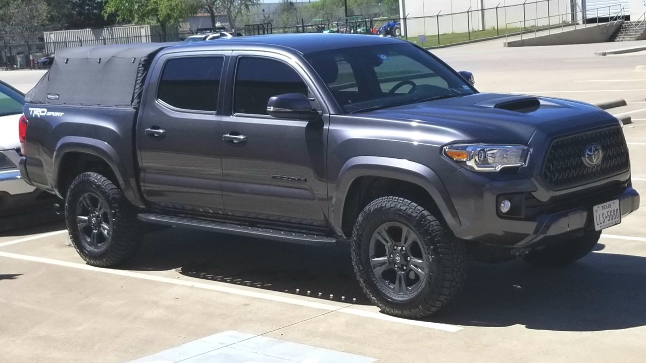

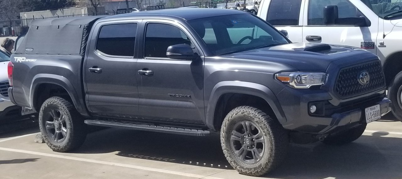

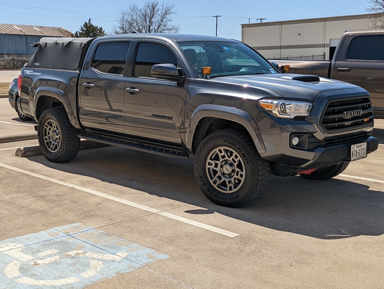

    Honestly I would do wheels and tires before suspension, but it's your truck, your choice. Here's my photo collage that I frequently post:
    Stock everything, no lift:
    +1 size, 265/70r17, stock wheels (+30mm), no lift:
    The same tires, 265/70r17, +4 offset wheels, no lift
    265/70r17 tires, +4 offset wheels, Bilstein 6112 lift raised 1"
    For me, the biggest bang for buck coolness happened with the wheels. Pushing each wheel outboard by an inch was what really made it prominent.
