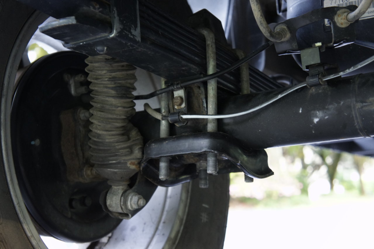

    U-bolt flip
    Stock
  10. Aug 22, 2019 at 4:35 PM

    Yeah I probably will do U-bolt flip while I'm in there. Any additional/special hardware necessary or just simple as re-installing upside down when you're done?
  11. Aug 22, 2019 at 4:37 PM
    rnish
    rnish Well-Known Member
    May 9, 2014
    #129450
    8,548
    Peoples Republic of Maryland (USA)
    Tacoma 2nd gen
    King's, Camburg UCA, Dirt King LCA, armor
    New U-bolts designed for flip. Stock will not work. I got mine from Wheelers with the Timbren bump stops.

    Oh I see now, they're rounded to fit over the axle rather than flat like stock. Thanks for info, I'm going to check pricing out for that.
