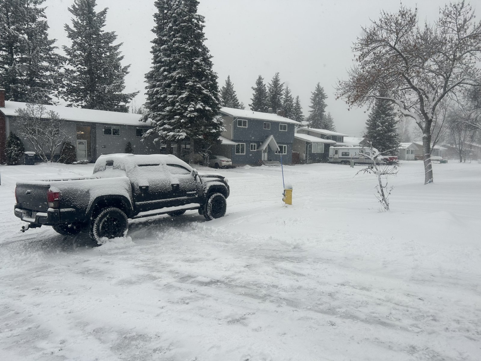

    I would not do more than 2”. When lifting, IFS suspensions lose downtravel fast and it’s hard on suspension/drivetrain components.
    I’m running 2887 OME coils, soft valved nitro charger OME shocks and dobinsons medium rear leafs (OME dakars tend to squeak). 2” lift. Stock UCAs.
    Absolutely love this set up except that I’ve only got 2 1/4” of downtravel and can feel my front suspension top out at times. Extended travel shocks would give you another 3/4” max.
