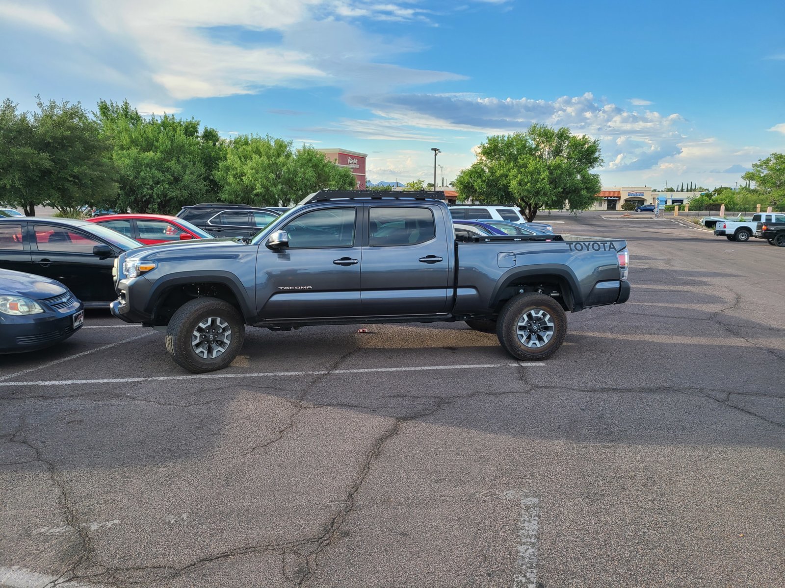

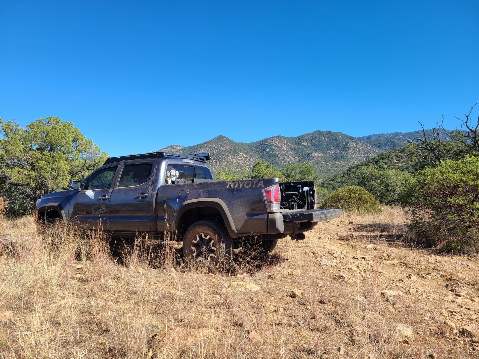

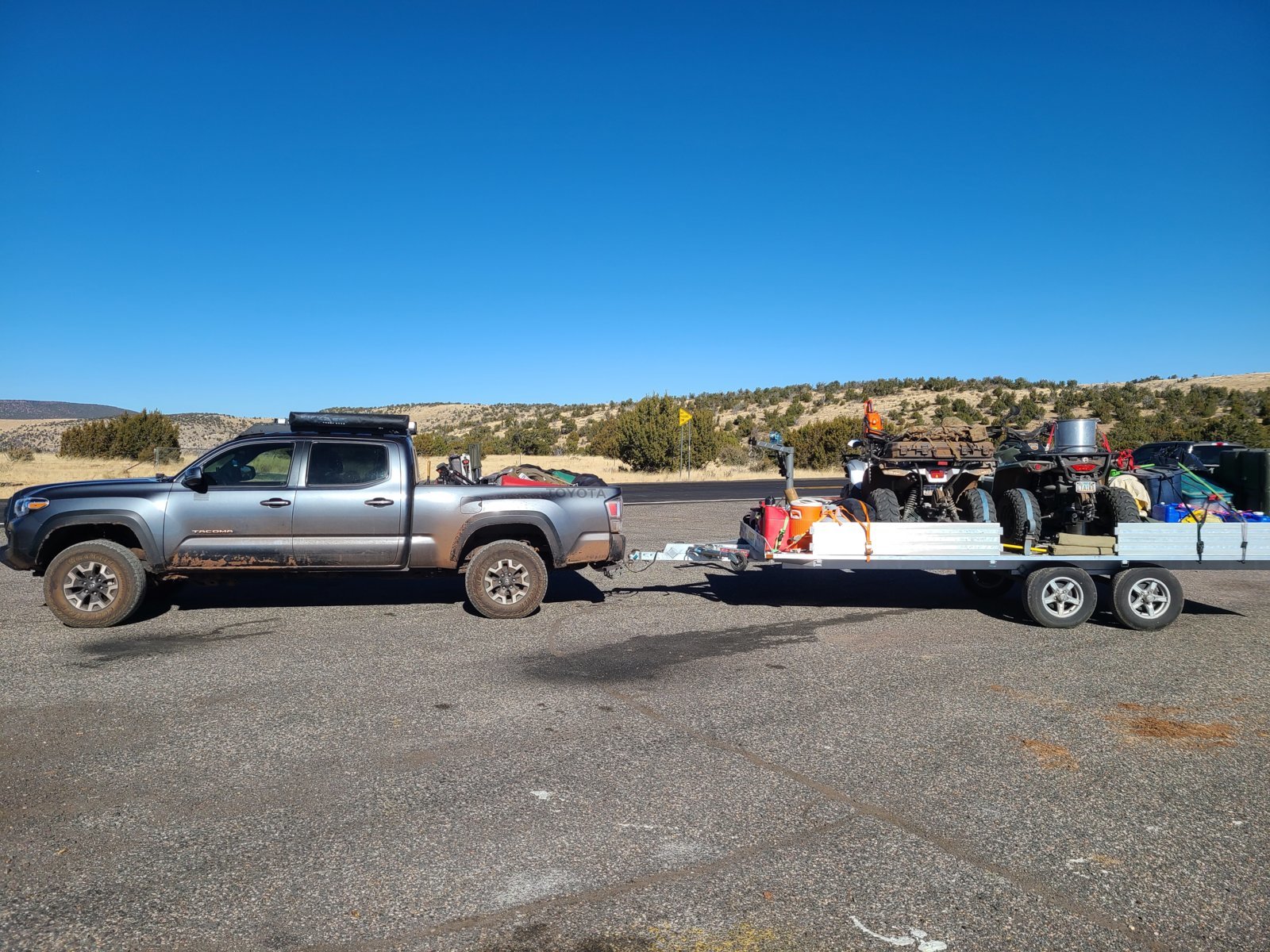

    I did the same research for about a year. Had almost every kit made in a shopping cart at some point in the process.
    I simplified my thought process on how I would actually use my truck. I hunt a lot in Arizona. Forest service roads suuuuuck where I go. I wanted the stock feel, but ability to tackle some harder forest service roads. Additionally, I wanted to haul my trailer with quads and equipment. But 95% of the time I am unloaded, so I did not want to add stiffer springs in rear.
    I ended up with Bilstein 6112s and 5160s. I set the 6112s at 1.7" lift. I installed a 1" block in the back to get it somewhat level. Then I added Ride Rite airbags to help towing.
    I have, for me, the best setup I could get for my needs IMHO. Did all of the install myself, alone, in my garage at home. Mas o menos 5.5 hrs. Rears were super easy. Fronts took a little longer because I also installed the ECGS bushing while I was in there. Got my alignment within the first week, and it was barely out on the driver's side.
    Pics:
    Hauling elk camp:
    Out hunting unloaded:
    Parking lot stance unloaded:
    Gonna look good when I wear out the stock tires and go up to some tall/skinnies...
