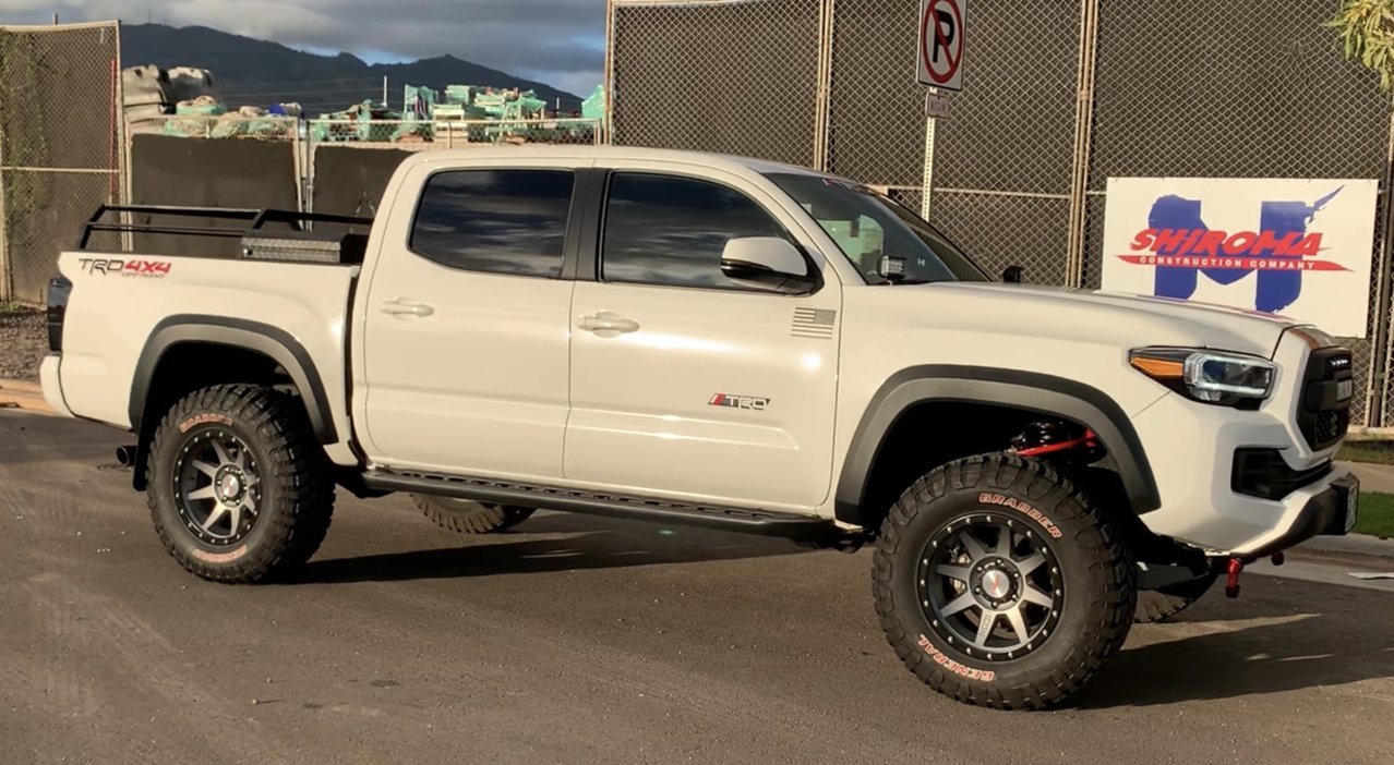

    I have basically the same truck as you. The Bilstein 5100's are great option. I have the 887 OME and they are way too soft for me. I'm thinking about going back to the Stock OffRoad coils. Stock coils are 700 lbs. OME are only about 600 lbs.
  13. Mar 17, 2022 at 4:05 PM
    TacomaCawd2007
    TacomaCawd2007 [OP] Well-Known Member
    Aug 13, 2021
    #374149
    88
    2021 Toyota Tacoma TRD 4x4 Off-Road
    Looks amazing!
