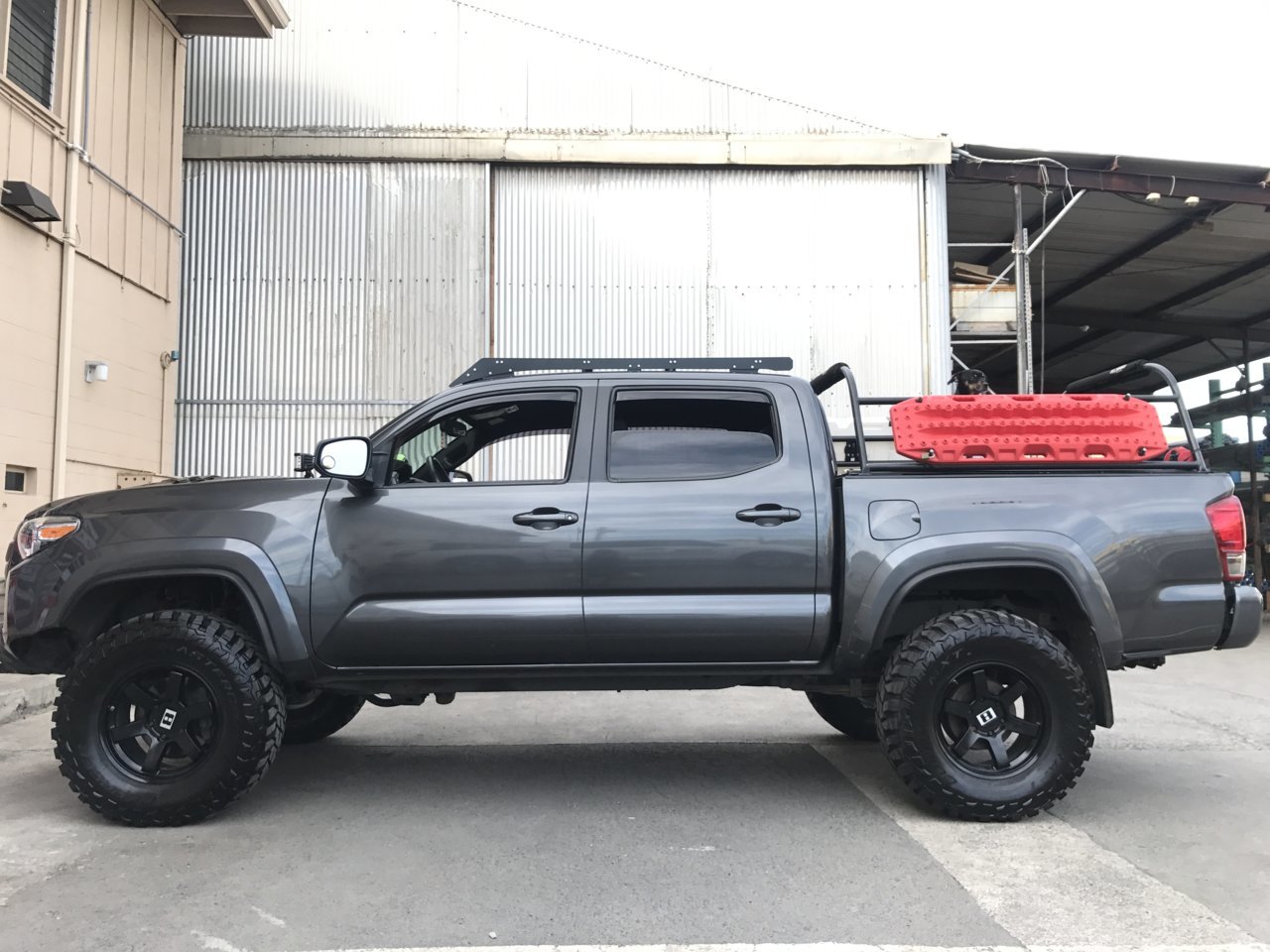

    Wasn't that bad fitting mine. Although I was really down to cut the front bumper regardless of putting on bigger tires.

    1,795
    For reference this is what 2.5" front and 2.5" rear lift looks like on 295/70/17 mud terrains. Looks like I have less wheel gap because my fender flare EZflares stick down a little bit.
