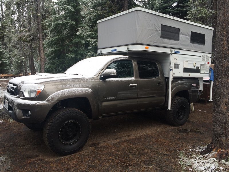

    Access cab with child seat in the back, yellow wire mod, diff breather relocated to tail light, engine block heater, Leer topper with Yakima tracks and rack, Yakima rack on cab, Ride Rite air bags with Daystar cradles, CBI hidden front hitch, wired for winch front and rear Warn quick connect, Warn x8000i on external carrier, sway bar delete, trailer plug relocated to under bumper, Pelfreybilt IFS and Mid skids, BAMF Tcase skid, ECGS front diff bushing, ARB CKMA12 compressor, 255/85/16 Backcountry MT 3 load E tires on stock steel rims, Toyo M55 tires (same size) on another set of stock steelies, Up2NoGood heated mirror kit, Husky X-act Contour front floor liners, Northstar AGM 24F battery under the hood, Northstar 27F in the cab, Redarc 25 amp DC to DC charger, Pelfreybilt bolt on sliders with kickout and top plates, TRD Pro headlights, Depo smoked tail lights, Energy suspension body mount bushing kit, OME Dakar leaf packs with AAL, OME rear shocks, OME 90021 front shocks with 885 coils, SPC LR UCAs, Up2NoGood 2wd low range mod, 4 Wheel Campers Grandby slide in camper, 4xinnovations high clearance rear bumper, Uniclutch 800 lb/ft clutch
    Do you want to do the minimum, or be beefed up properly. Air bags will get you the support you need with ability to fine tune your ride. You'll still be putting major stresses on your stock leaf pack on acceleration and braking. If you're the type to over build things, I recommend Dakars with Timbren bumps. I have Dakars with air bags because I added air bags long before my leaf pack. Air bags replace your bump stops and need to always have at least 10 psi - which adds more lift than I'd like. The Timbrens are there when you need them, but aren't in contact with anything when your leaf pack isn't flexed. DoorDing has the setup I want (he's been MIA for a long time, but I think his build is still up).
