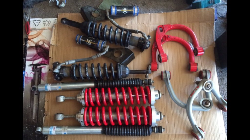

    Go with the icons your going to be much happier than using toytech if your budget allows. Not saying toytech are bad but from experience there's a night and day difference. Install yourself super easy and get the firestone lifetime alignment. If getting standard coil overs UCA's are not needed but I would recommend them at some point you will notice a big difference. Here's some of my older stuff just sitting around the garage collecting dust so trust me and do some research on the forum and get informed before a purchase.
    64484EAC-35D9-4D36-88BB-D59E60442565_zps_b685ad67b6d8b1ed7884645b4736cc360ec2f4de.jpg

    Man if your not hard core wheeling why not just do some 5100's and your choice of coils? Save you a ton of cash, and they would be fine for what you are doing. But don't get me wrong of you got the cash for Icons than do that!

    Man I hate to see that stuff cluttering up your garage! I'll get it out of the way for ya! Lol

    Ya some day ill post all the crap lying around for sale. Im more of a buyer than a seller and tend to just throw stuff away, much easier than trying to sell stuff not needed anymore.
