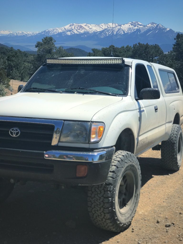

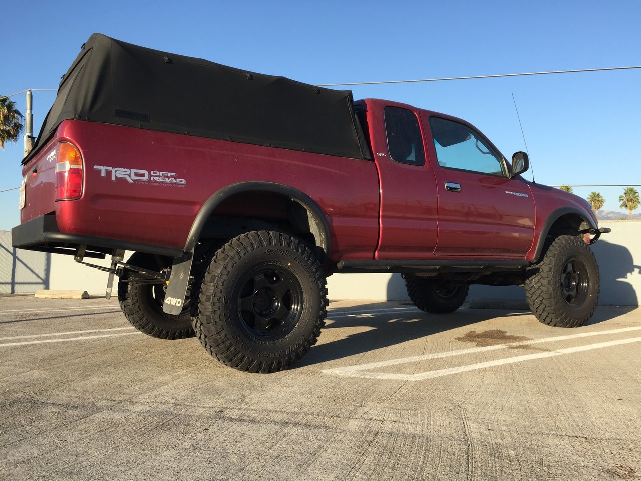

    The previous owner put them on, I they are MB Motoring 352's, I *think* 16x8? Tires are 265/70 R16, also *I think*. I'm not at the truck right now and I always forget the exact numbers.
    I put the front struts at the middle setting for 1.5" or so lift since I wasn't sure about alignment. The back was sagging, and that picture doesn't really show it but I have a definite rake now.
    Here's the before. So I guess I got a net 1.5 in front and 3 in the rear? starting from -1.5 in the rear lol

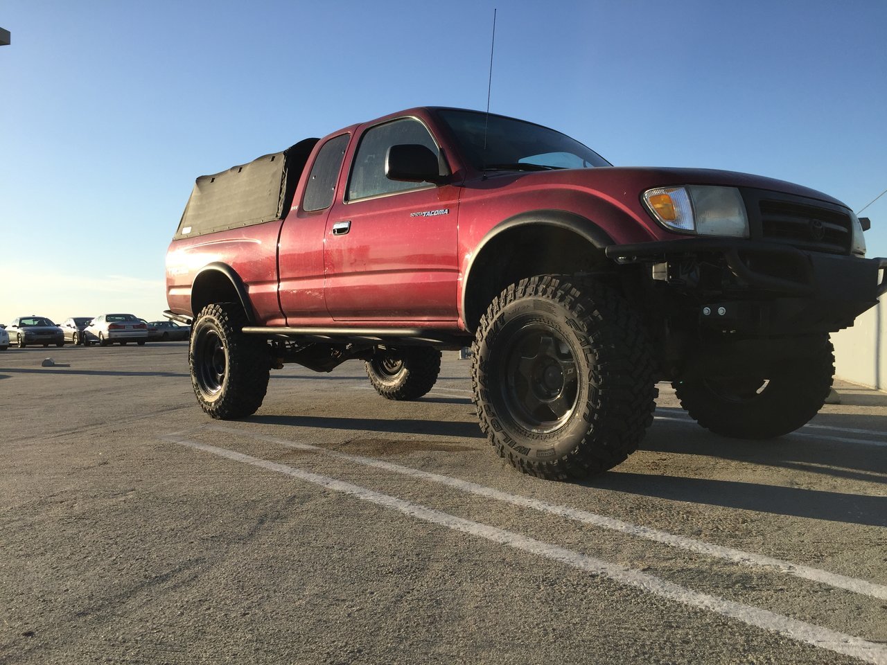

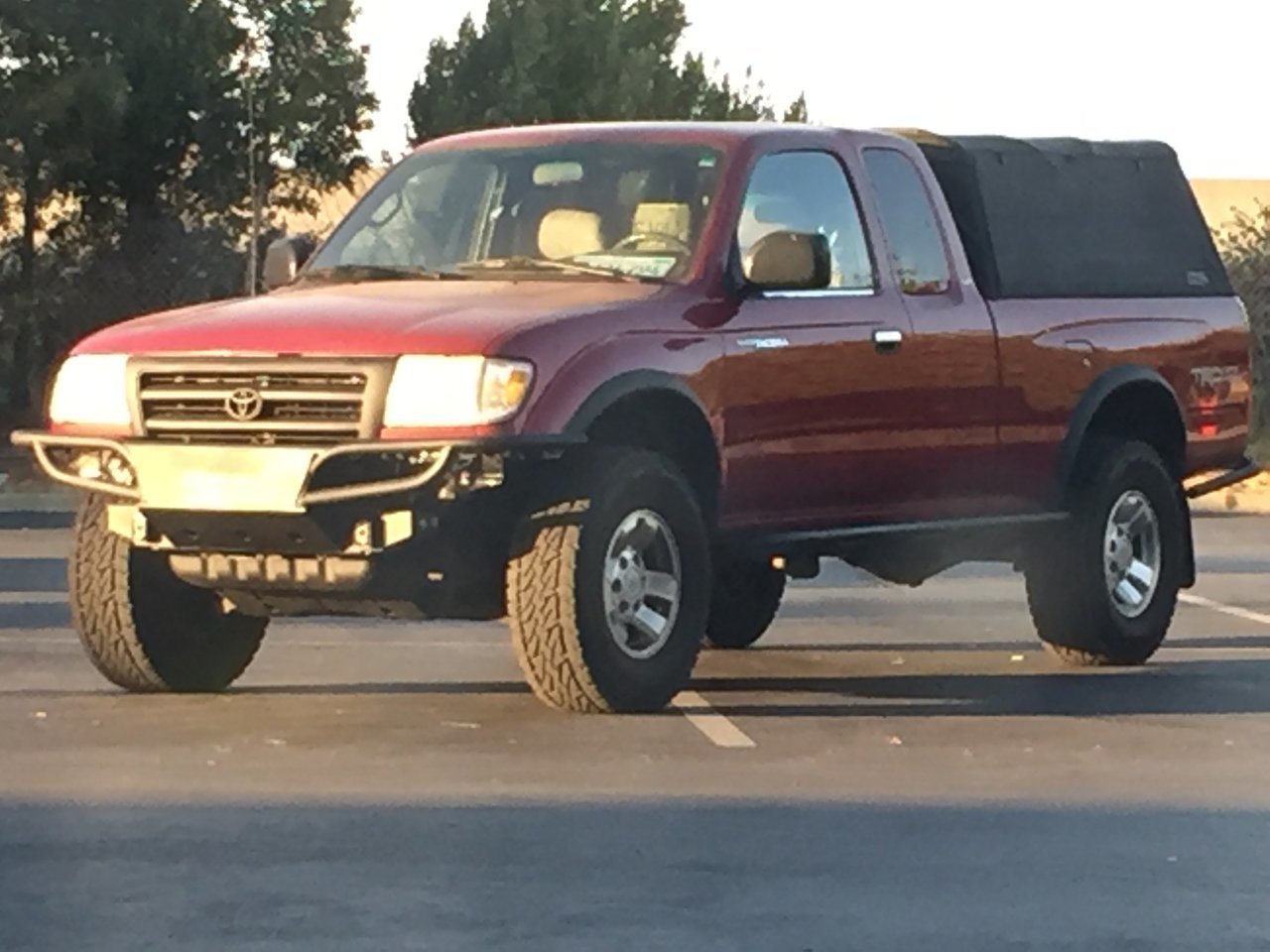

    My take: do it right and get it done right the first time. I figured out exactly what I wanted, researched a ton, spent months collecting parts. Then installed everything in one long day.
    My thought behind is was, my truck has 114k I want it forever so might as well replace the whole suspension and get it the way I want.
    Before
    After
    So if your just looking to replace the rear leafs, with something to give you some lift, replace everything. Might take longer but it's worth it.
