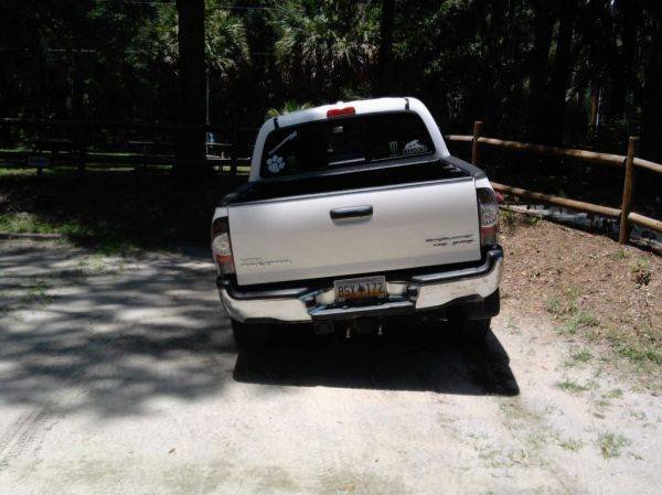

  13. Mar 6, 2016 at 7:24 PM
    Lawfarin
    Lawfarin Who me?
    Oct 25, 2015
    #167659
    7,951
    Beetle Juice
    NY
    2024 GMC Sierra
    It's not a problem unless it looks like this
