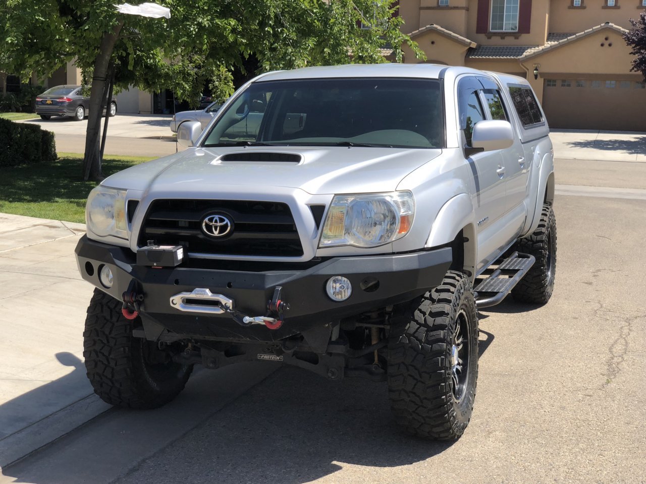

    My question is, is the bilstein 5100 with the factory springs be sufficient enough for the weight of the front end or do I need a beefier spring to put in the 5100’s? This will still be sitting under the 6” spacer.

    Here’s a pic of my front.

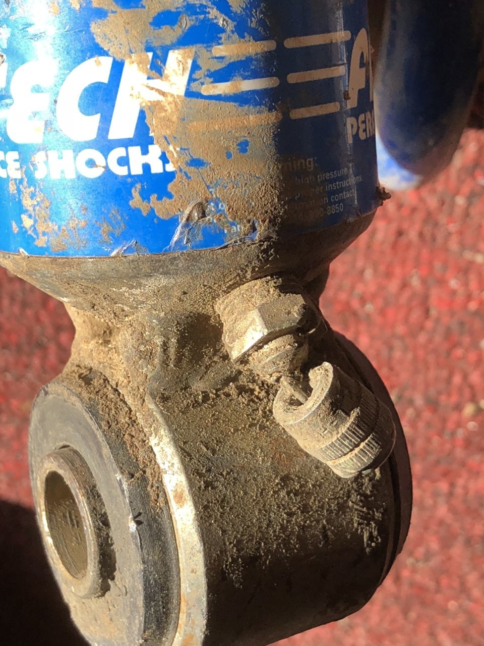

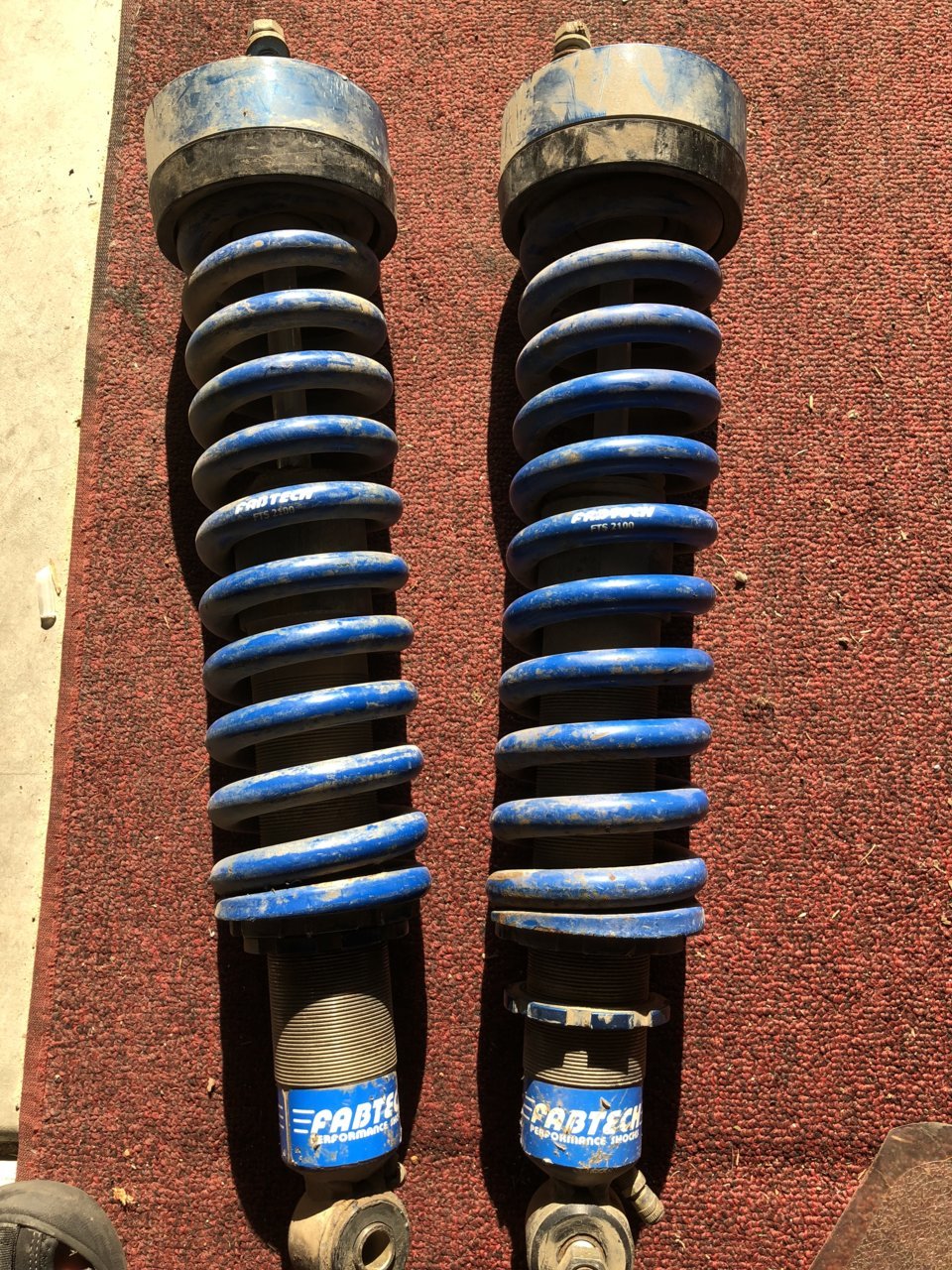

    Thanks! Just updated it. Once I get home I’ll take pics of the front suspension.l and everything under. Not too sure but it doesn’t look like the front is sagging to me with the factory shock/spring under the spacer. I think what happen to the previous owner is that the fabtech shock got busted as one of the valves broke and he changed it to the stock ones. Here’s pics of the shock/springs that the previous owner gave me and of the busted valve on the fabtech.

    Looks repairable to me... Take it to a place that rebuilds shocks and have them rebuilt... Those will by much nicer than the spacer lift.
    If you determine they cannot be fixed I have a set of used 6'' Lift coilovers I could sell you.

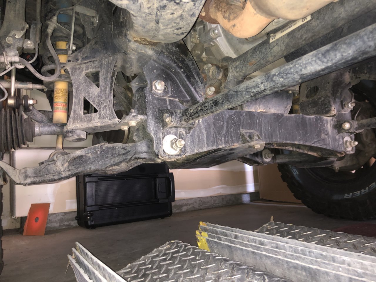

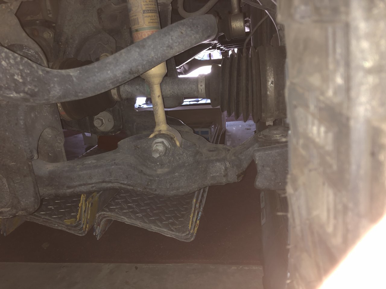

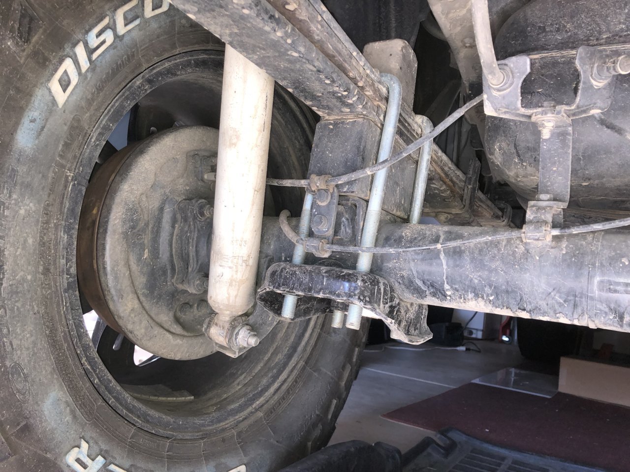

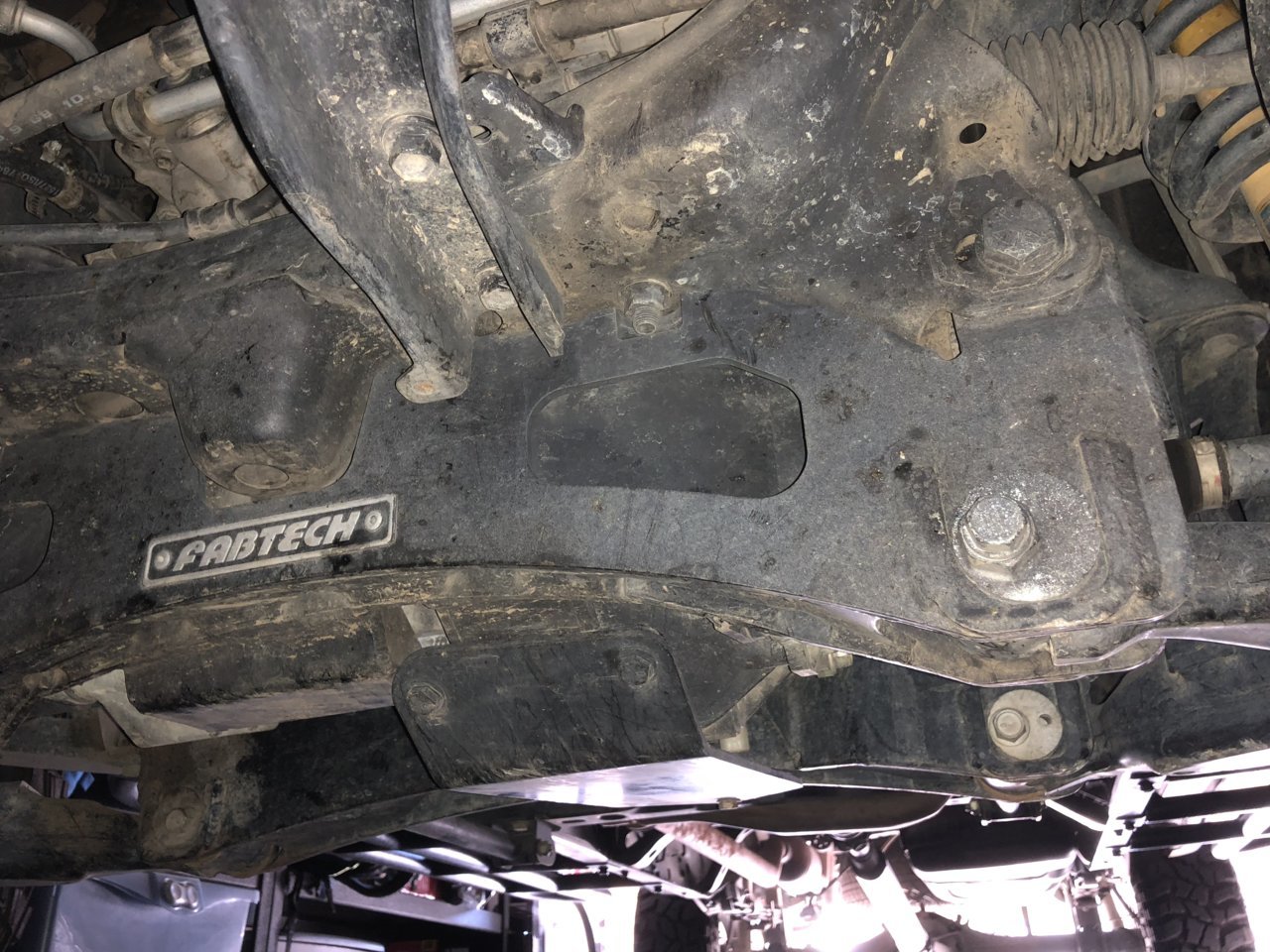

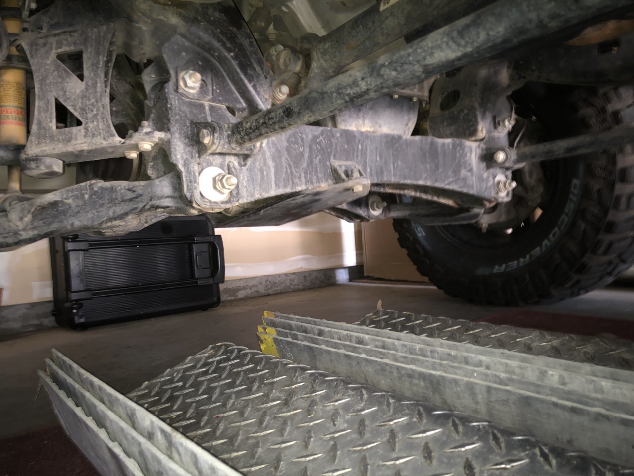

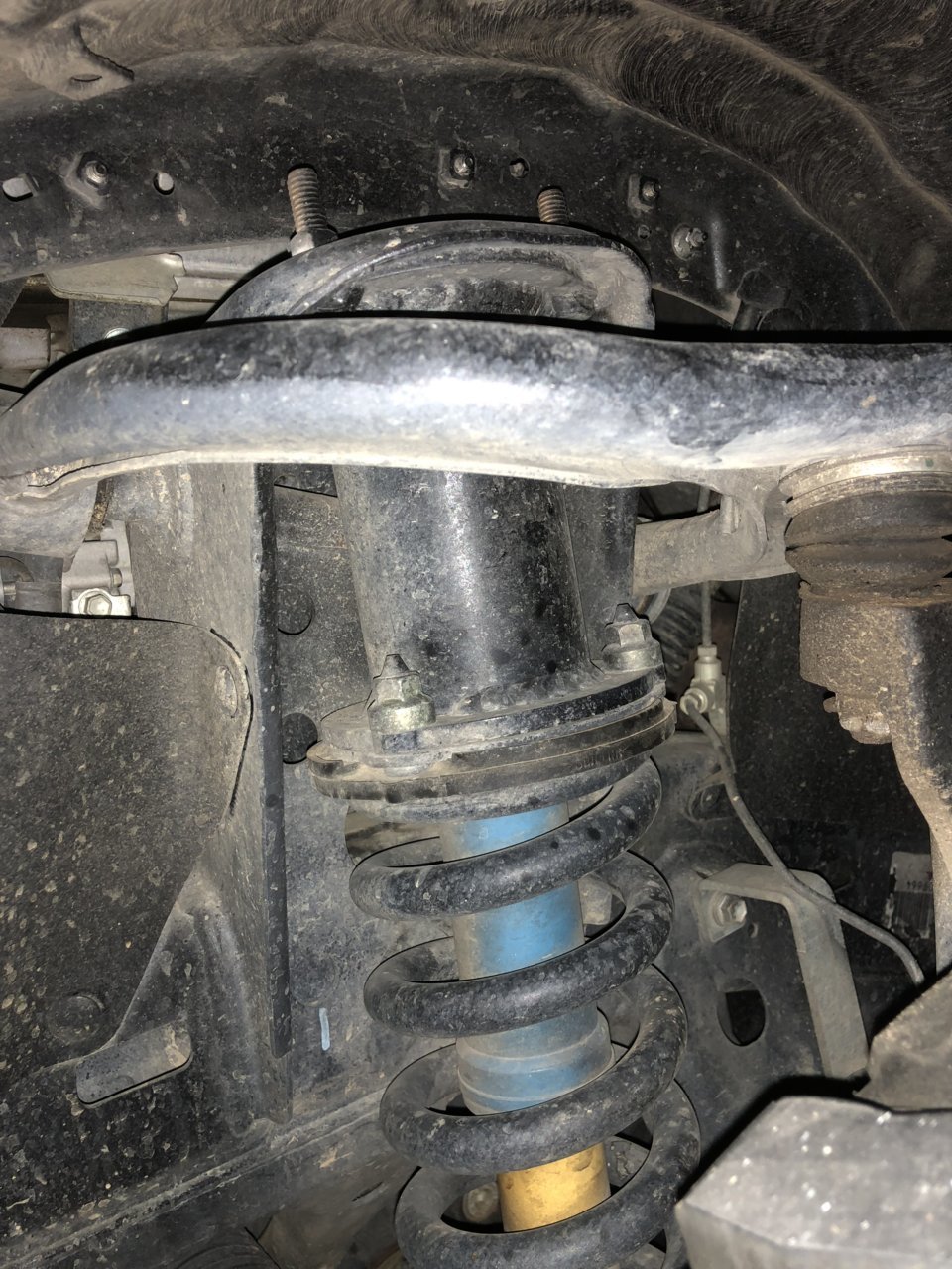

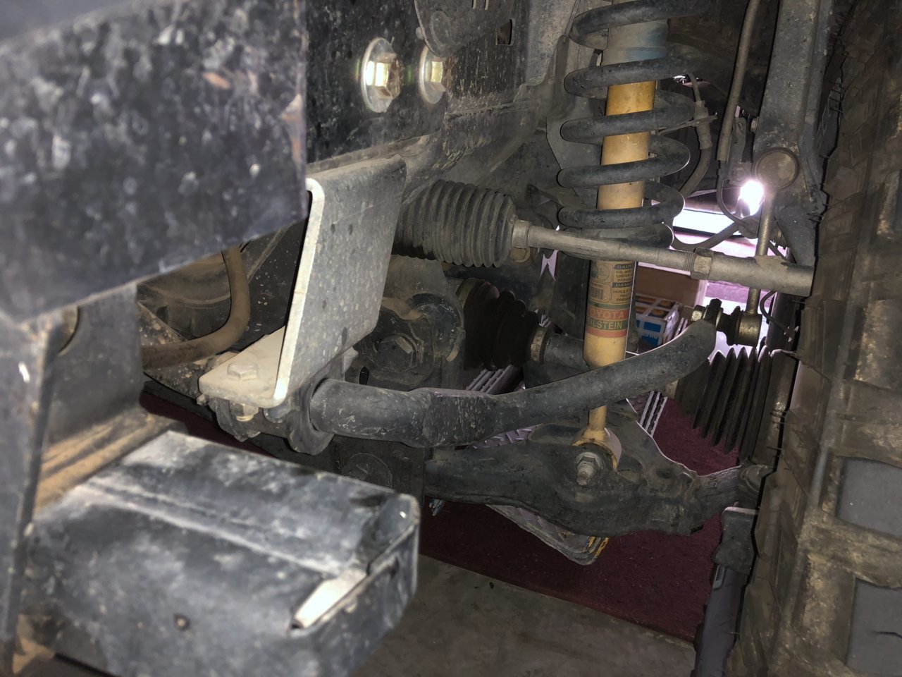

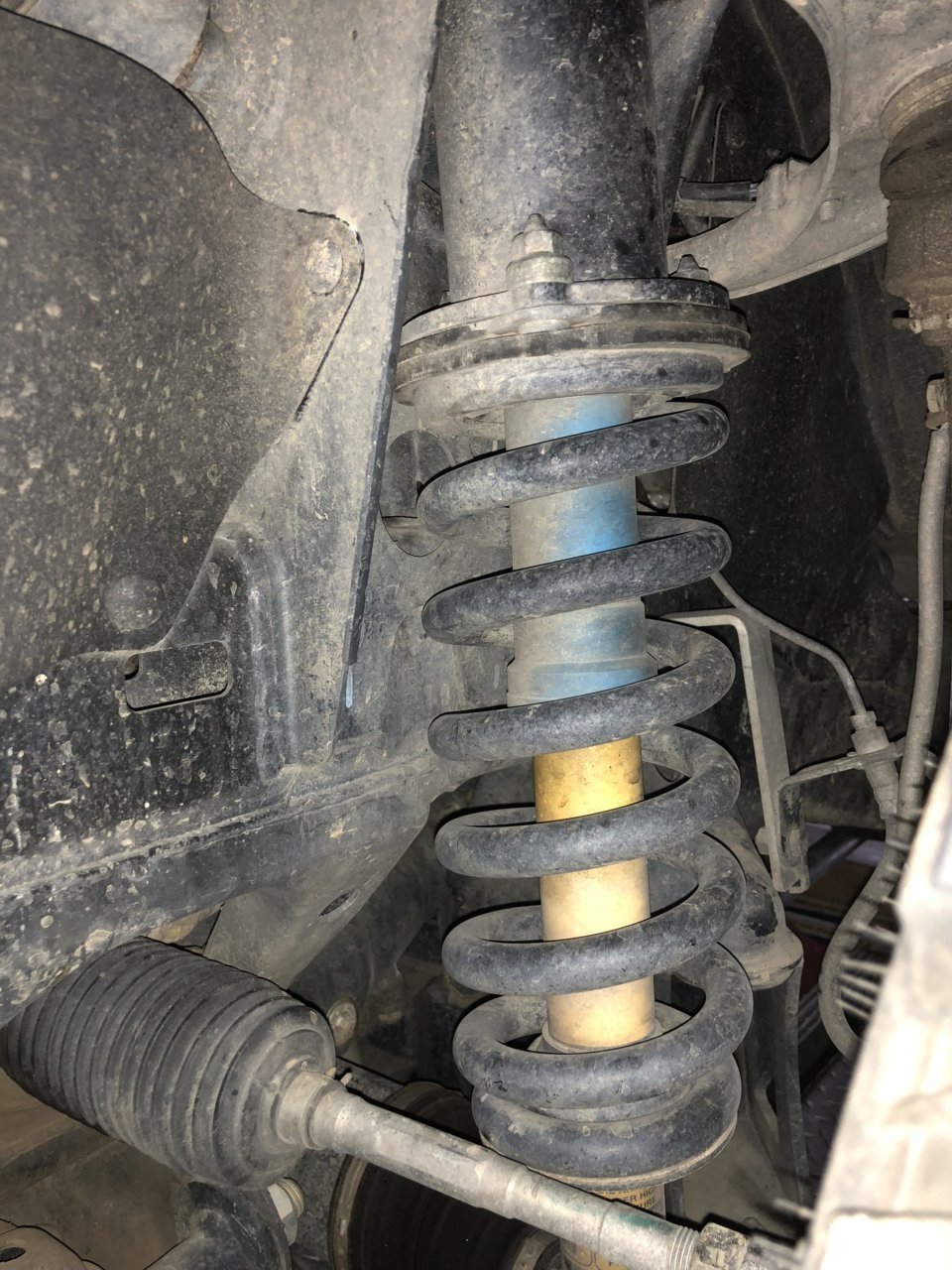

    Here’s some pics. What kind of lift do I have? Bought the truck like this. Will 5100 work with these springs or get better springs or sell 5100 and get coil overs.

    That’s just the oem TRD suspension with spacers. If you want the 6” lift I suggest looking into all new components to get the desired lift and selling the 5100’s. Or you can keep them and get some OME 887 coils and do a 3” lift. Which is a really nice look on these trucks. Either way I strongly suggest not using the spacers. You’ll get better performance all around with new shocks/coils over spacers.

    I guess your problem is you need like an 887 coil for the extra weight of the bumper and winch, but they don’t come in stock height to work with your lift spacer. I’d recommend first ditching that lift block in the back and switch to a new spring pack.
