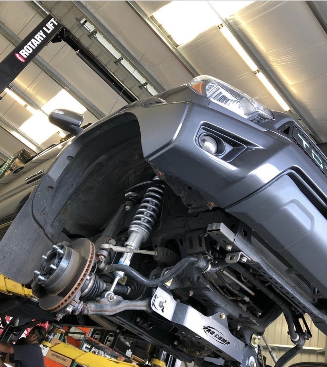

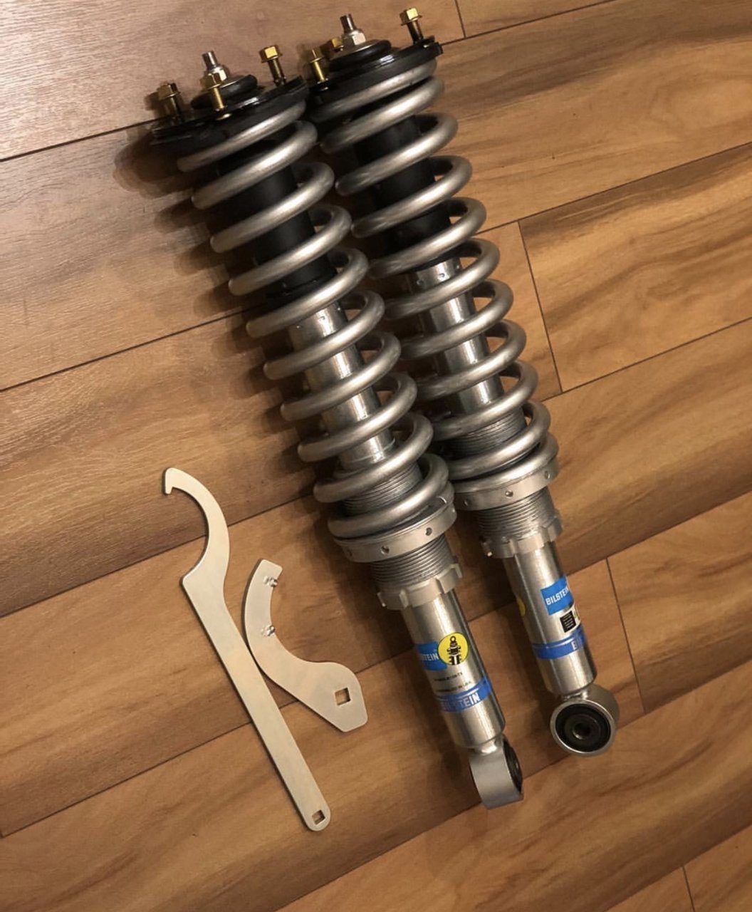

    Thanks. In the second pic it looks like a coilover sleeve over the 5100’s. Can I do that instead? If so, where can I find the sleeves, springs, caps, etc.? And long enough to replace the 6” spacer.

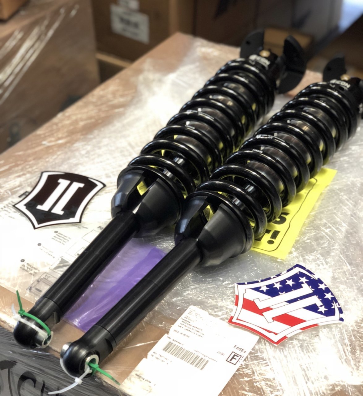

    Ok guys, I’ve been thinking and will take your recommendations. I’ve decided to go with the coilover route and ditch the spacers/blocks. Took my truck to 4wheelparts and the guy told me I have a fabtech basic 6” lift kit. And recommended, since my kit is fabtech, that I stick with fabtech’s dirt logic 2.5 6” lift coilover (kit # fab fts26059) at $1388.55 after tax (parts only, uninstalled). (https://www.4wheelparts.com/Suspens....aspx?t_c=1&t_s=90&t_pt=3306&t_pn=FABFTS26059)
    I’ve also saw that icon makes a set at $1575 before tax/shipping for the 6” lifts (http://iconvehicledynamics.com/shop...ift-adjustable-front-coil-over-shock-kit.html)
    A little about how I use my truck....Truck will be driven about 3-4 Times a month in city/highway about 10-15 miles each time and will probably only see dirt trails or long distance trips during hunting season. So in a year it only gets about 1000miles at most. Keep in mind I have an aftermarket front bumper, winch, and sliders. No towing/ major hauling.
    So for the fronts only, will either fabtechs or icon c/o mention above be a direct replacement of my factory shock/spring and fabtech 6” spacer? Which one is a better investment? Will either support the weight of my vehicle? Or are there other better options out there. I want to get something that is a direct replacement of the spacer and shock/coils used in the fabtechs basic lift kit. I prefer to not mess with any other lift parts. Also at the best price for what i use my truck for.

    @Tuby07 The Fabtech coilovers are the way to go if you're looking for the best ride. There is specific valving and spring rates that are tailored to the Tacoma with a 6" lift and bigger tires, and are better suited for supporting aftermarket bumpers/winches. There is also no problem running the spacer with the stock shock/springs either, and you can probably find a lot of good cheap sets that guys are taking off when they change out their suspension. Basically, you can't go wrong with either setup. The coilovers that you were given are actually for a 95.5-04 Tacoma 0-3.5" system and wouldn't do you any good...

    Thanks greenefsi. Man so many options. Was going to do coilovers but can’t really justify the cost for how my truck is used. So I was leaning more towards the extended bilstein 5100 used in the RCD lift with either OME 886 or the eibach springs.
    Any recommendations, suggestions, pros/cons of this setup? I really don’t like the huge spacer.
