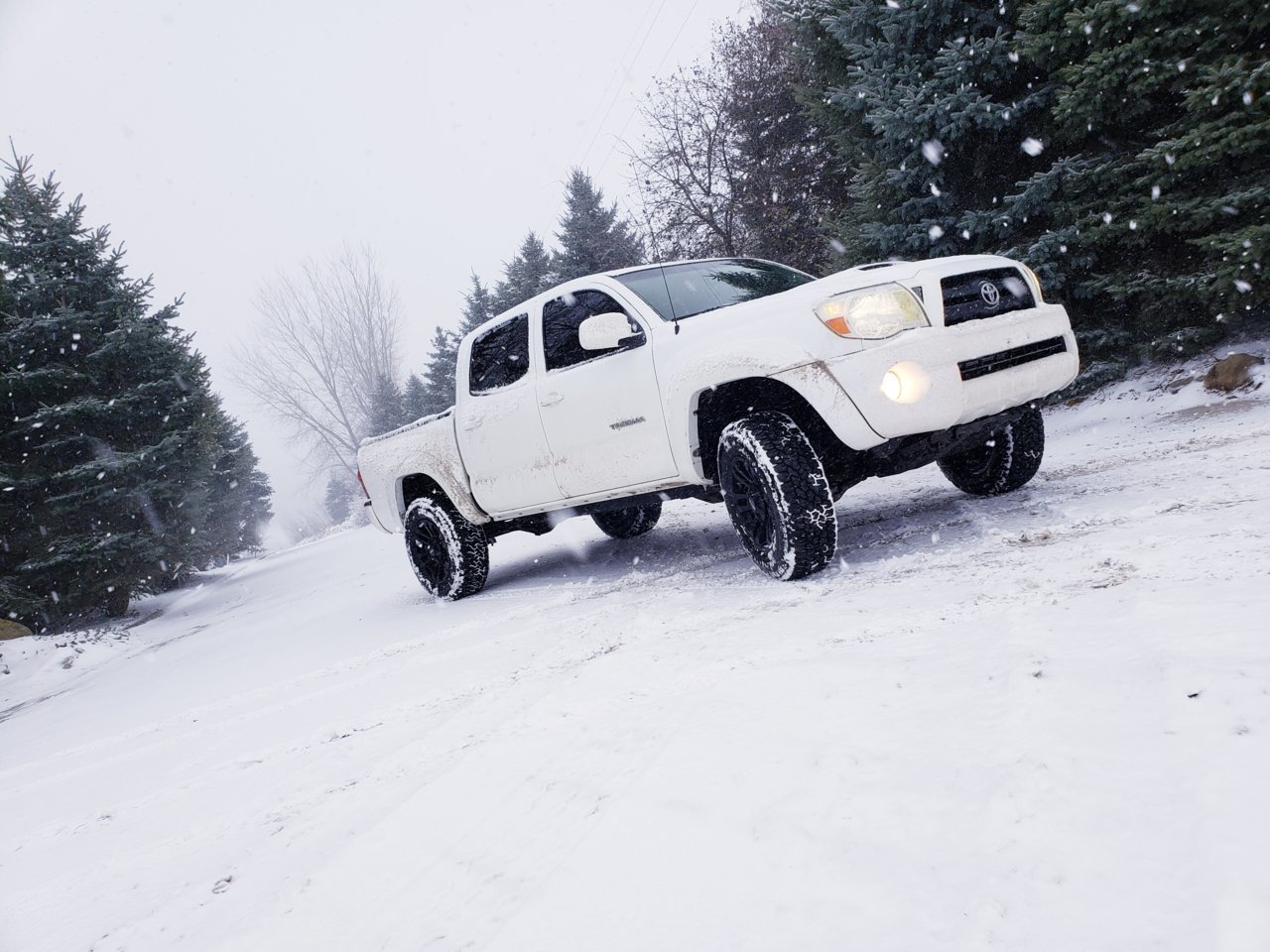

    Here is the truck, dont have photos of the shocks but I know they are Rancho front and back. I just had my leaf springs replaced due to recall and now my rear end sits almost 3 inches lower than my front. I have blocks on the way for now but want a whole set front and rear.

    Hard to say without seeing the set up but you probably had an add a leaf in the old leaf pack that gave you the lift in the rear that was not switched over. As for the shocks there are a lot the will give the 2.5 to 3 inch lift in the front. There is a lot of info in the suspension section of the form. Do feel obligated to stick with the same shocks when switching out.
