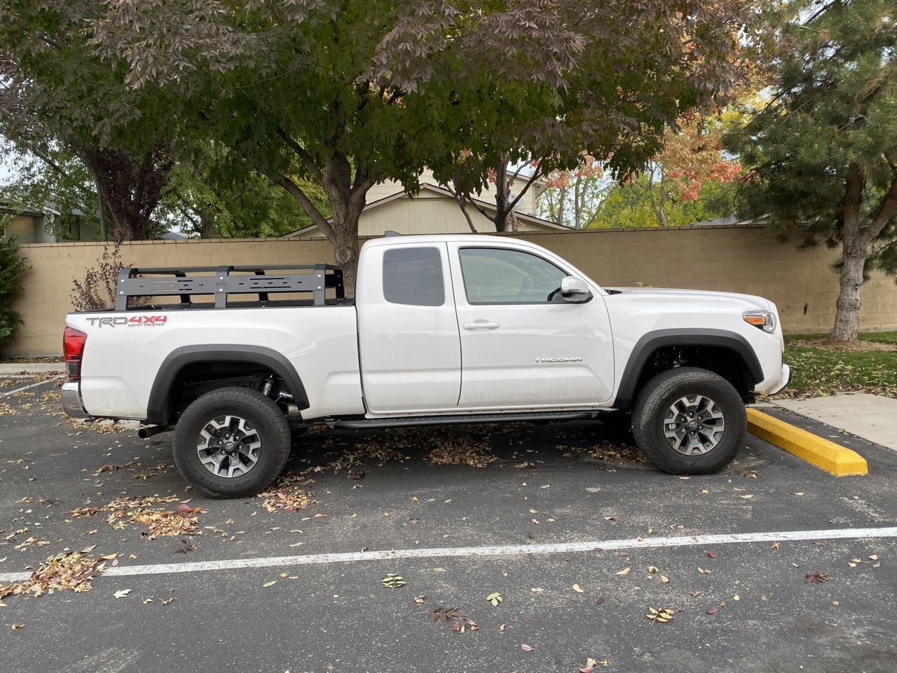

    I’m in the same situation and settled on the Bilstein 6112/5160 through Headstrong.
    I’ve only ran the set up for a few days and love it so far.
    It’s not terribly expensive like true coil overs however it’s not an entry level lift either.
    Getting the suspension installed professionally with the ECGS bearing and upper control arms costs a pretty penny too which is why I didn’t want to buy an entry level suspension kit. Do it once and hopefully like it.
    That’s my opinion. Check out the 6112 thread for more details.9EBB9ECB-CA70-4C13-B66C-F1FA2DFEED7E.jpg
