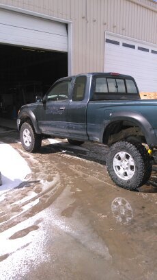

    1457552375338.jpg Got mine from Rocky Road Outfitters. Both the web site and the guy who I talked to on the phone, from RRO, said to remove one or two leafs for ideal ride height. They were not kidding. I even opted for the "heavy duty" set, might have been a bit much..... Great service and these are great rear LS!

    So you have no lift in the front? Just new leafs? With 1 or 2 removed?

    You have tons of clearance in the rear!

    sicyota04, yes "tons of clearance in the rear". I also added new OME shocks and lift springs to the front. So, front gained 2.5-3" rear gained a "ton!" In the picture that I posted no springs were removed. I am building a flat bed and will wait till complete to see how many leafs I will remove for ride height. Also, before you begin make sure you can get your spring shackles unbolted. Had to cut my bolts off, so having new handy may save you some time.
