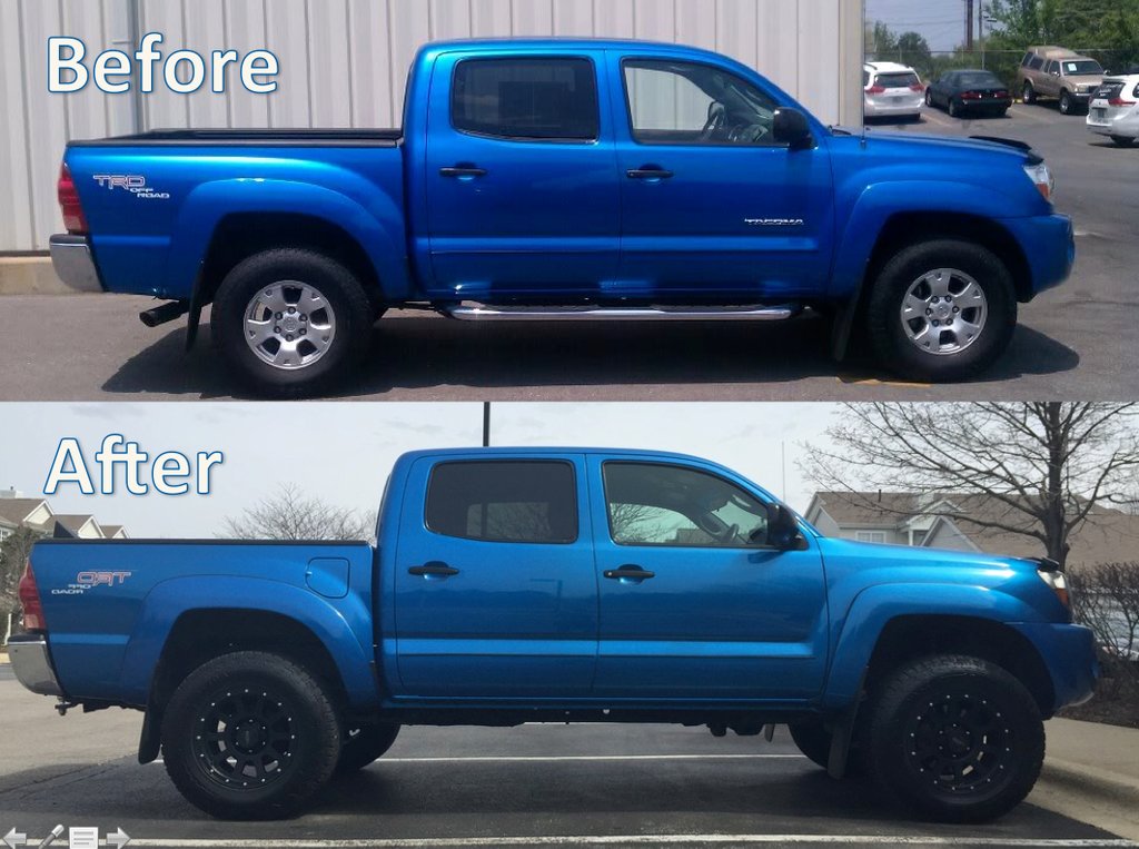

    Haha i know, the pic is flipped :eek: but i went with 885x coils and the billys set at 0 (came out to be 2.5 inches in the front). My goal was to be as level as possible

  11. Apr 24, 2015 at 11:21 AM
    cfayne
    cfayne Well-Known Member
    Feb 7, 2015
    #148121
    1,110
    Santa Clarita
    2012 Tacoma V6 six speed FUN
    Pro Comp wheels General Grabber AT tires
    Ok, I am fascinated. Not by the flipped photo, but it seems you have done exactly what I was thinking. I just purchased some 5100s with a Deaver aal for my access cab. The seller said about 1 to 1.5 inch lift in the back. What did you run in the back? I was on the fence on how to get the front up. So you went 6112s in the fron with 885 springs with NO FRONT END ISSUES? You are running all stock upper and lower arms?
    YoyYour truck looks like it is a wee bit high for my wife. Are are on the max setting on the front shock/spring setting or is there room to go down a bit.
    Anyone with any subsuggestions on how to go the front up would be appreciated.
    By the way, the truck is a daily driver. We LOVE how the truck drives on the street and do not want to risk losing the plush ride so if you have experience with this set up, please let me know.

    He got the coils to get the lift vs having to preload the factory coils just using the adjustable shocks. The lift achieved from the coils depends on the truck, for example if you have a double 4x4 V6 most get approx. 3" with the 887, 2.5" with the 885 and 1.5-2" with the 884 coils. With an access cab you will end up a little higher since there’s less weight.
    The shocks he's running is the Bilstein 5100 shocks not the 6112s, those don't work with the OME coils.
    With this set-up you might need aftermarket UCAs depending on the lift height, but there shouldn't be any issues as long as you keep it at or under 3", preferably under 3". 2” or less is ideal though.
