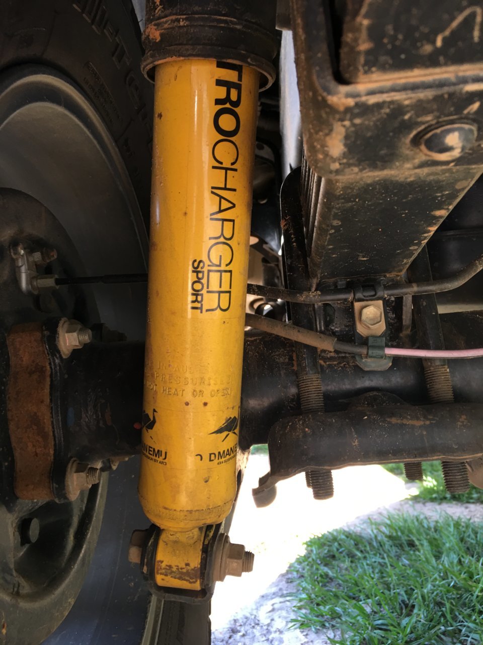

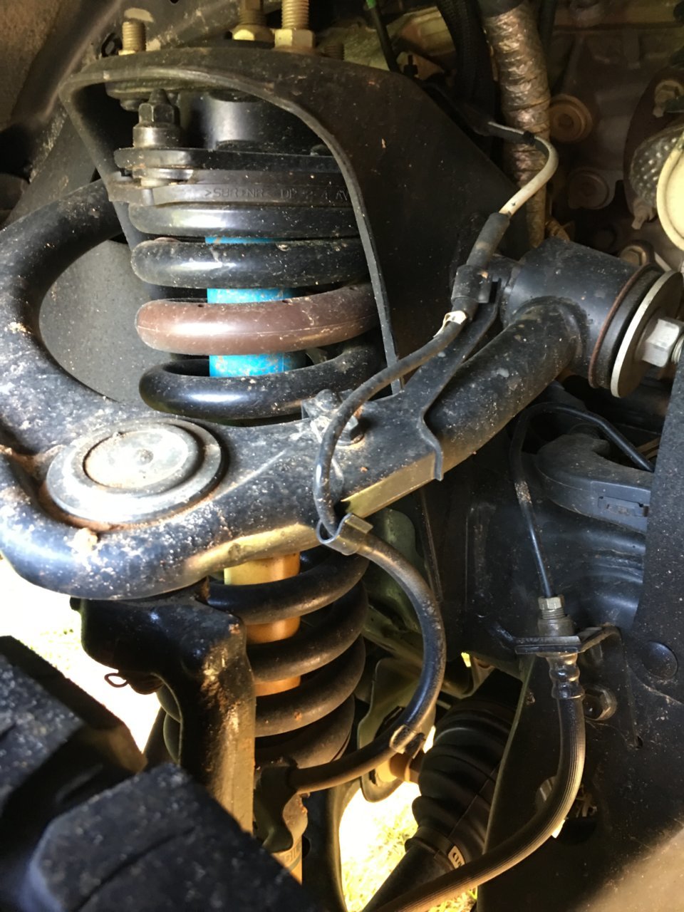

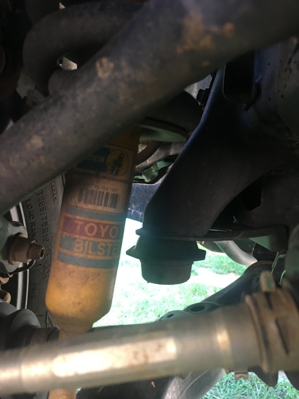

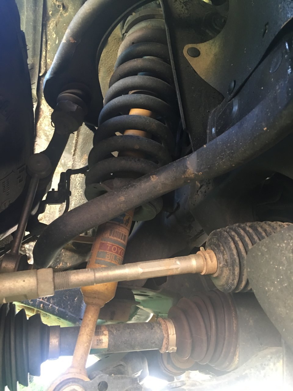

    So, I recently purchased this 2018 DCSB TRD OR. had around 40,000 miles on it when I purchased it. Whoever had it before me had definitely done some mods. The dealership listed it with a 3" lift. From what I've gathered, it has Bilstein shocks and coilovers in the front, OME aal in the rear with ? shocks. At one time it had a subwoofer or something because theres a knob to the left of the steering wheel that doesn't seem to do anything.

    2. What all am I running as far as suspension? From what I've heard Bilstein and OME are "good"? Can it be adjusted? Should it be squeaking really bad in the rear?

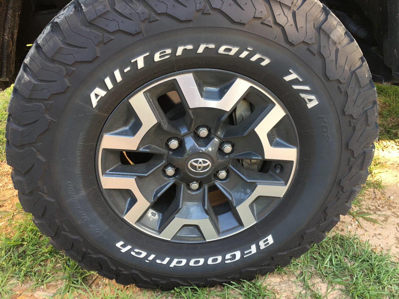

    3. I like the tires, but are these the "best" with this suspension setup? Can bigger tires be added later? I have a pretty bad "shimmy" when reaching highway speed. Maybe an alignment or balance will fix this?

    KO2s very common tire here it gets the job done. It’s mostly to preference.
    Rear is Old man emu rear with most likely an add a leaf
    Front is OEM off road Toyota Bilsteins with what looks like a spacer.

    Looks like a spacer lift in the front with stock springs/coils
    OME springs with Dakar springs in the rear
    Nothing can be adjusted on this setup as they are not the Bilstein 5100/6112 shocks.
    The tires are BFG Ko2 tires. They are good tires and many here run them without issue. I'm just going to assume they're 265/70/17. You could go bigger but you will be trimming plastic in the wheel well or cutting the cab mount.
    The shimmy could be alignment which may be out of spec due to the spacer lift. You may need new upper control arms to get it back in spec but the first thing I would do to investigate that would be to have the alignment checked.
