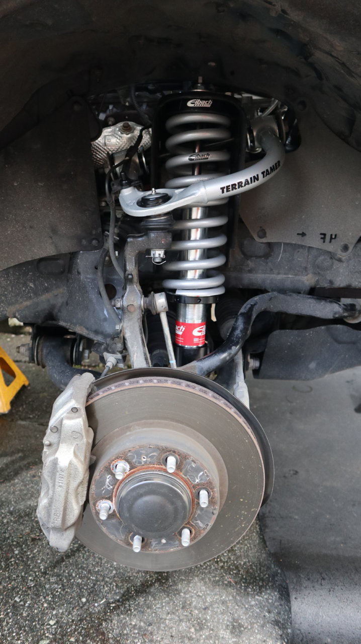

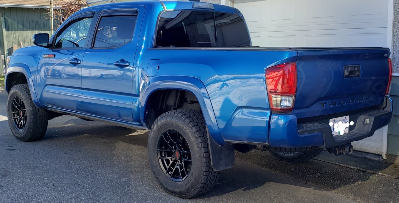

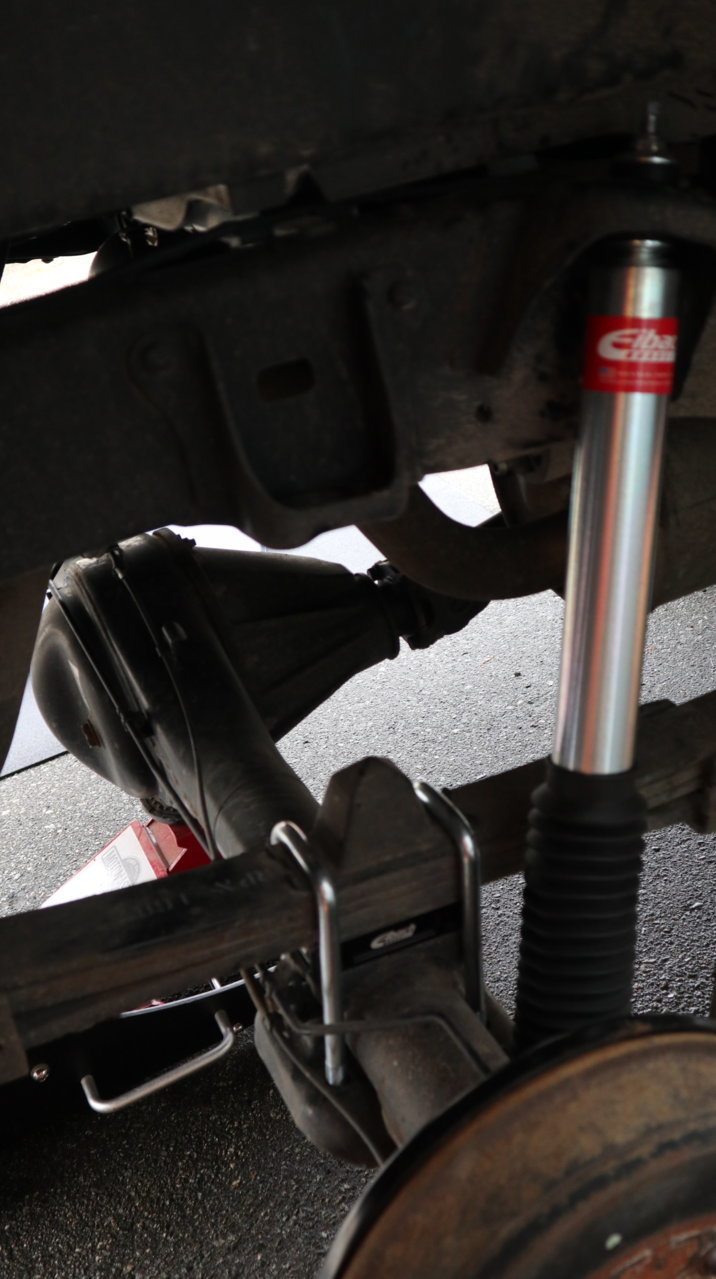

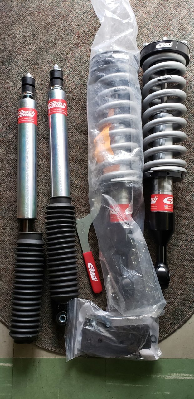

    As @71tattooguy says, you can't go wrong with the kits he listed.
    I just installed Eibach Pro-Truck Stage 2 with 1 inch blocks and stock leafs in the rear. In the 3 weeks I have had it in, I have found that it is quite the improvement in ride quality. I put the kit in as supplied. And have no plans on increasing the lift.
    20211001_174115.jpg 20220303142645_IMG_0898.jpg 20220302114248_IMG_0873.jpg 20220309_113958.jpg
    I ended up with 1.8" in the front and oddly 1.7" inches in the rear even though i only added the 1 inch block. I guess the gas charged shocks help give it a bit more of a bump.

    looks good, what size tire?

    265/70R17's on ART Replica 237 17×8's with +5 offset.

    I call bullshit on your bullshit call :poking:
    After I changed out the stock Sport suspension to the Pro-Truck, I found the ride in my daily driving to be much nicer. The first hit is still firm but the rebound and recovery is way better. Before I likened it to having steel bars in place of the shocks! It was jarring and jittery over rough roads. Now I feel the first bump and then it is smooth... after 4 ½ years with the Sport suspension I, can say that you can make it better with a shock change.
