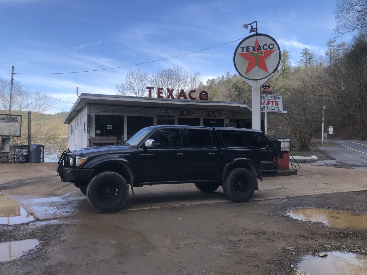

    IMG_5560.jpg I’ve had OME 881’s for about 12 years with Dakar Leafs, Nitro Sport struts. Very dependable set up and 100% does the job. You’ll be all in at about $1300. They have over 150k on the set up. Needs replaced but still going. I do have a 10mm top spacer b/c I run a bumper /winch.
