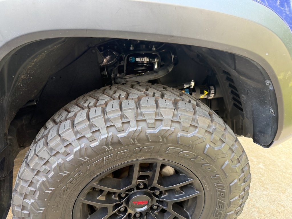

    I have the 8100 DSA in the rear on my Tacoma.
    At full droop with my Icon RXT leaf pack on option 2 (just over 2" lift unloaded) the shocks are about 3/4" too short.
    For my kinda offroading articulation isn't the priority, going fast is and let me tell you those shocks let you go fast.
    50+ mph on stuff I wouldn't do at 30mph on my previous shocks and I can count on one hand the number of times I've felt the bumpstops hit hard. Plus I am running a lot of weight in the bed while doing it too.
    I paired them with 6112 up front because, unfortunately, I am not made of money lol

    possible that your leaf/shackle bushings were limiting droop? dsa version on 8100s are actually shorter than bone stock shocks and have only about 8" of stroke. the bypass version is an inch longer extended length after that.
    i think others should use the same offset lower mount that icon uses on their rxt version of their shocks to gain overall travel without sacrificing uptravel. the icons net 2.5-3" more wheel travel over the base 8100s. i believe the oem trd pro foxes do this too actually. like said wheel travel isnt everything but when valved correctly 25% more travel is huge.
    i have the icon omegas out back and they can absolutely mob on a fast whooped out road. they far outperform the front icon coilovers. i would have to get their secondary front bypass shock kit to have them perform as good as 8112s would up front. which i plan to do actually.

    It was when I was installing the shocks.
    I jacked up the truck from the trailer hitch so the rear axle was at full droop and with the shock top bolt installed the bottom bolt hole was about 3/4" short.
    For me stock travel was plenty, I only have upgraded rear leaf pack for my truck weight.
    Maybe one day if I decide to get more into crazy offroading I would go 12" with new rear shock mounts but for my current uses 8" is plenty for me.
    Another thing I have is better bump stops and those alone help tremendously over the OEM bricks that come on the truck. I am running Perry Parts bumps front and back
