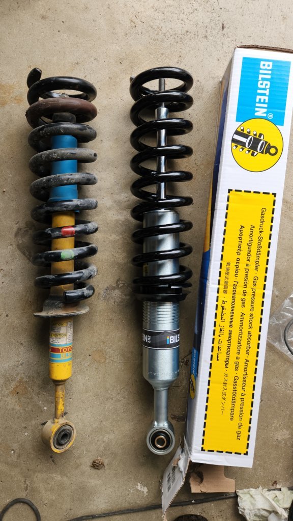

    I haven't seen published length specs on the 6112s from bilstein so would be nice to get firm confirmation that the new ones havn't changed but those are the numbers I found on tacomaworld. I think I remember eyeballing my 6112s with a tape measure and it seemed right but I wasn't very scientific about it.
    Here is a side by side with the stock OR shocks.
    Spacer isnt on the shaft of the 6112 in this pic but you can see the longer overall length and the long threads. After installation there was a good amount of thread still sticking out the top so extended the spacer atleast a bit should be doable without too much struggling to get them on.

    the specs you have posted are correct. looks like spacer can be used to shorten or lengthen by a half inch depending on application. also looks like the newer dark gray bodied 8112s are a half inch different than the older silver bodied shocks looking at specs. If i ever buy a 3rd tacoma id get them just to try.
