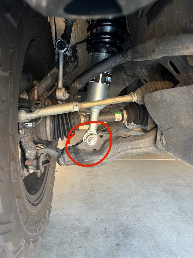

    I had the front right knock over speed bumps while turning and such. I just ungraded my suspension and opted for new lower strut mount hardware up front. Consists of 2 bolts, 2 nuts, and 2 washers. All in all about 20 bucks from the dealership. I’m glad I did because the passenger lower strut bolt was slightly bent and in bad shape when I removed it. No more clunking up front after the new hardware.
    I’d recommend going with some 5100s all around and maybe an add a leaf if you don’t want to shell out the cash for all new leaf packs. Doing an add a leaf gives you the chance to take your leaf packs apart and clean and lube between them to get rid of any squeaks.

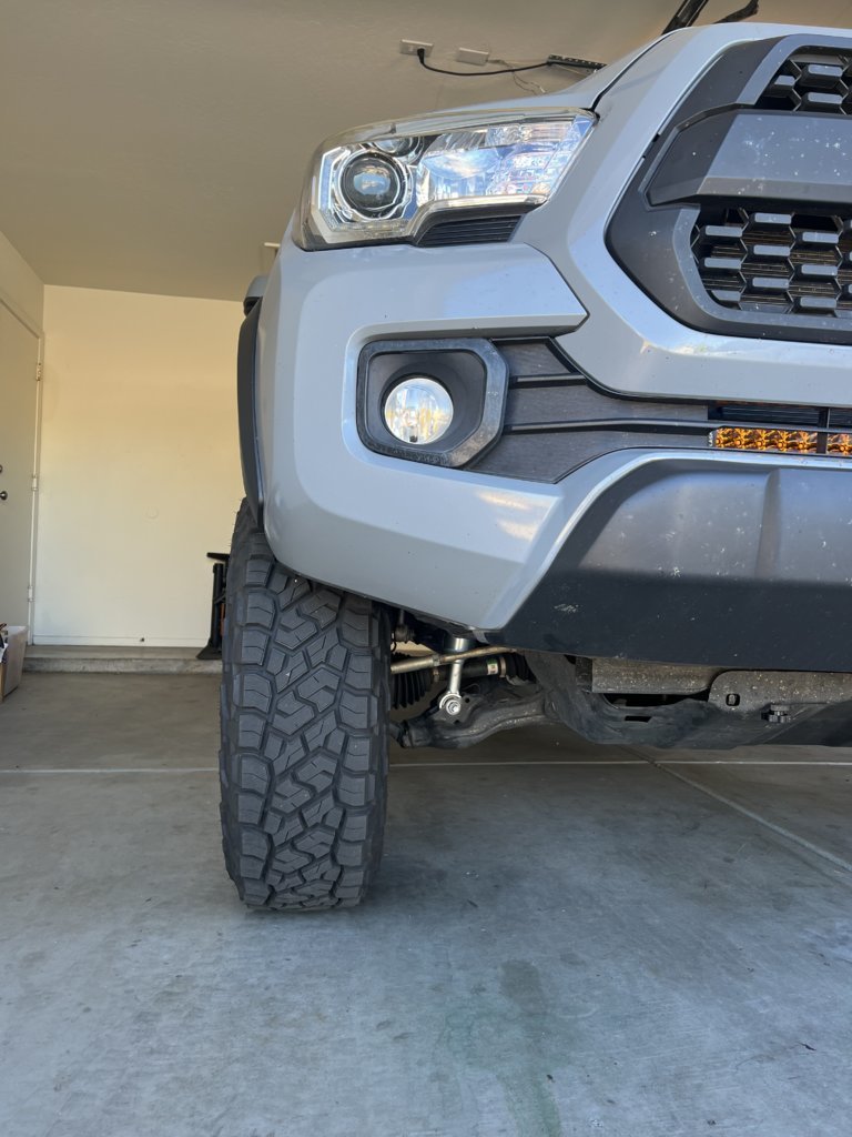

    I appreciate it. Can you send a photo of what a lower strut mount and hardware looks like or where it goes relative to the wheel well?
  5. Nov 13, 2024 at 12:39 PM
    stoney1911
    stoney1911 Professional Idiot
    Oct 16, 2023
    #435603
    51
    Phoenix, AZ
    2019 TRD OR DCSB

    Well I’ll be damned I should’ve done more research and went with those instead of new OEM hardware. It didn’t even cross my mind to look for aftermarket hardware that’s beefier in the right places. Thanks for the link, I’m going pick up a set.
    eurowner[QUOTED] likes this.

    Another dumb question, do I need to get the truck off its weight in front with a jack to replace the bolts?
  10. Nov 14, 2024 at 5:32 AM
    TS4x4
    TS4x4 Well-Known Member
    Mar 15, 2022
    #392650
    1,025
    2018 TRD Offroad
    Absolutely. Otherwise it could be extremely dangerous if you just pull that bolt while compressed.

    ^ this. jack it up to obtain full droop!
