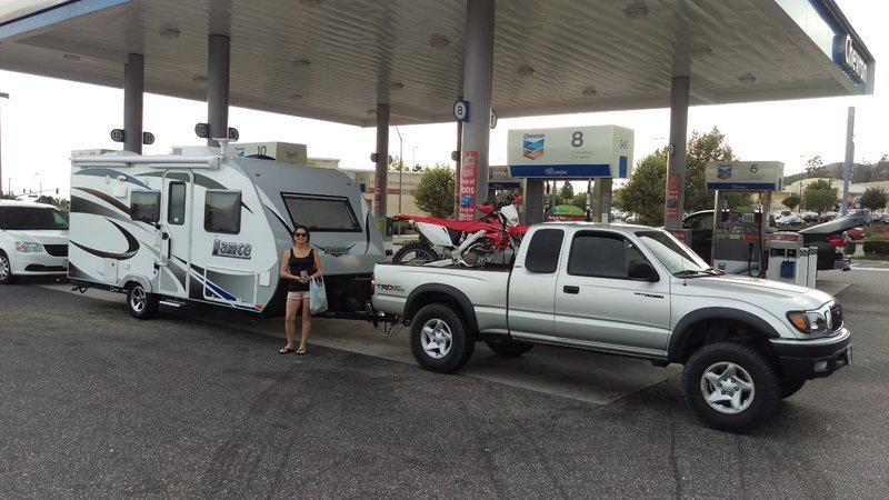

    IMAG1715.jpgAs she sat getting ready to climb grade up to big bear.

    Were you able to keep a decent speed going up that grade?

    Maintained an easy 45mph, could have pulled more but the motorhomes were slower. That helped as I didn't feel like I was the one backing everyone up.
    Did also have to stop because a bagged mini truck was broke on the worst part of the mountain. Got right back up to speed with no issues.
