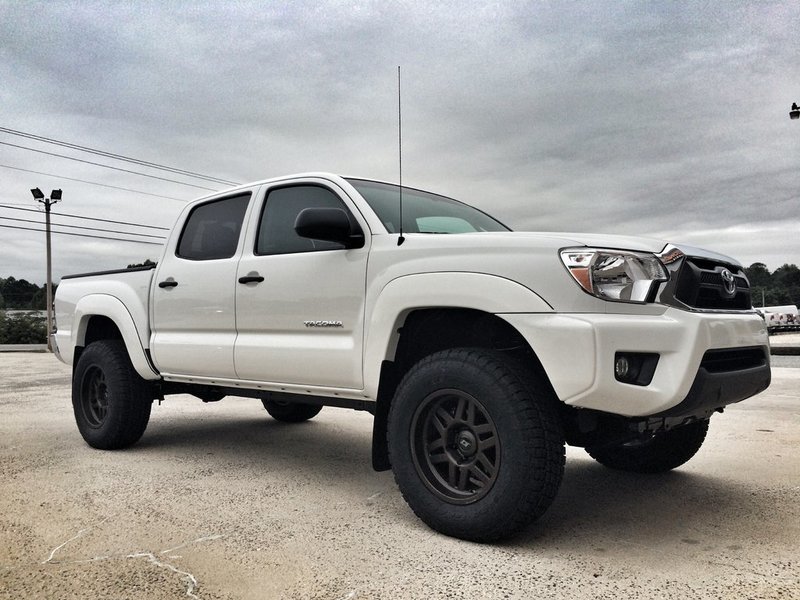

    1.75" Billy's plus 1/4 spacer on both sides. 1" block in rear. 265/70/17 nitto g2 SCS matte dark bronze 6s
    4WD w/ 5100s at 1.75 plus 1/4 toytec top plates on both sides. 1" block in rear with 4 leaf pack
    265/70/17 g2s

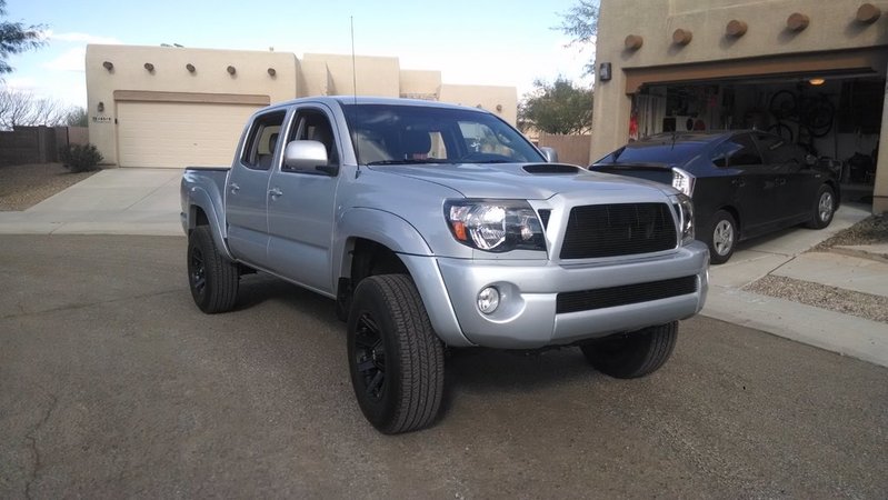

    5100's set at .85 from down south motorsports. 1/2 inch toytec spacer on the driver side and 1/4 inch spacer on passenger side. 2014 X runner rear leafs.

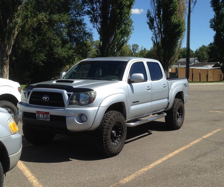

    OME 887 lift, 16" XD addicts, 285 duratracs, leather seats, badass JL/Focal stereo
    This is the bilstein/OME bundled kit from headstrong off-road. 5100s all around (set to 0 in front), OME 887 coils up front and an AAL in the rear. Truck is 4x4
