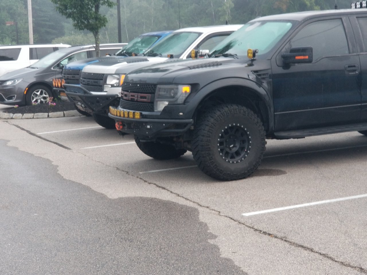

    Buy a bigger truck that can fit big shocks without cutting? But at that point buy the raptor. Random raptor row next to my work last week. So many lights!
