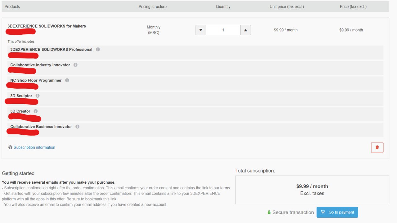

    it doesn't look like I can do FEA on a hobbyist license. A standard add on for simulations is $2,194.00/year :'(
    I hope I'm wrong, but I don't see it included in the list below.

    No experience with Fusion360 but $40 a month isn't too bad for all the extra's included, but for hobby related tasks it is still a little up there so I feel that.
    That's correct it is not included which is why I asked and there's no way to include it for a Makers/Hobbiest license either, for solid modeling it's hard to beat but it's limited on the Makers license. You could export your drawings into a free FEA software for your testing but sometimes files from a certain programs don't always play nicely together.
    If you're okay deviating from the big guys in CAD, you could look into https://www.freecadweb.org/ for your designs and https://freefem.org/ for your simulations but when talking free not sure you'll find something that encompasses both in a package but if there is something I'd like to know too!
