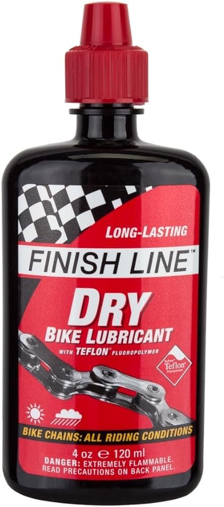

    what do you use to lubricate it?

    I have the total chaos uca and I use the finish line lubricant for the uniballIMG_9258.jpg
