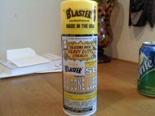

    Yeah! Forget about WD40, that shit sucks. More than likely your best bet is to get some real grease up in the joints(taking shit apart). You can try a silicone spray too.
    Buy at Home Depot
